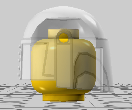

You have sharp eyes, Prateek! It looks like you are right looking at the side view below. However, I don't have the physcial helemet so I can't compare. Can anyone confirm that the LDD helmet sits to high comparted to the real deal?

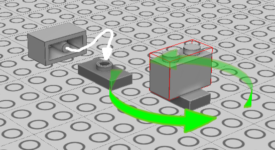

You cannot rotate a 1-wide brick or plate placed with the halfstud pin on a hollow hole.
I.e LDD lets me do this using a window frame but not with a brick.
(but deleting the window frame lets me place a brick on the rotated guide which fits on the hollow stud)
Excellent point pacc. I'm surprised this have never come up before, since it's such a basic technique :wacko:
This naturally leads to the question: has this technqiue (rotating on hollow stud) ever been used in an official set?

You can rotate brick without stud on that base, and use it to trick LDD.
You can do that excercise - put the windows on bricks then put the 2x1 stepper bricks on top
and bridge the 5 stud gap by putting a 1x6 plate centered using it's intermediate pins...
It's the same bug over again, but becomes much harder when you have two rotated bases on one stiff brick.

Yepp, none of them work.
11 -Part 6119 cannot rotate properly on Part 30124.
Good find.
12 -Technic pinhole on Parts 53457, 2695, 44359, 75535, 32126 will not accept system attachment.
32126 and 53457 will not connect because it's most likely modeled as a half beam, and none of those accept studs in LDD as of now (hopefully in the future). At least that's my guess. One reason for this is that there seems to be an issue about putting studs in from both ends in a half-beam (which is not possible with physcial bricks since they would collide).
75535 I heard was fixed in the next release (some good news I suppose)
2695 was good find - never heard of that bug before!
13 -Parts 32199, 61356, 30191, 71923, 71986, 57274, 63142, 6211 cannot flex.
Yepp, we all want more flex in LDD :classic:
14 -Part 45590 cannot flex or stretch.
Same as above
15-Part 30396 cannot accept towball attachment.
Reported just a few days ago actually
16 -Parts 54654, 57028, 43750, 40395 cannot be painted multiple colors.
The first two I heard about, but not the last two. (speaking of: shouldn't the last two connect? I can't seem to get it to work).
17-Part 44358 will not accept Part 44359.
Yes, that's a known bummer.
18 -Part 30644 will not accept stud connections on lower surface of rotors.
Not sure I understand this. Is is the grooves running along the underside you mean?
Another thing I spotted is that the center hole will not accept a stud top-down.
19 -All plates have a boundary error: Technic cross axle cannot recess slightly into tubes on lower surface.
Good point.
20 -Parts 55296, 55297 cannot be attached to open studs.
They will attach to a 3062 for example, but do you mean the won't attach to a hollow stud? If so, are they supposed to? The ends of the 3.2 mm bar pieces are slanted.
21-Part 44572 has bad render.
Where? Can you please show.
22 -Part 4095 does not sink into Part 6143 properly.
Aha, you mean from the underside, right?
23-Part 47905 does not connect to Technic.
Yes, there a quite a few of that kind that doesn't - 87087, 4733 etc
24-Part 58176 cannot connect to Part 6269.
Have you verified with physcial bricks that it should?
25-Part 6587, when connected to Technic by the stud, does not properly sink into the Technic pinhole.
Ah, yes, that's a known one, and very annoying one.
26-Hinge error in part 44567: When attached to 1x_ bricks with click hinges (parts 30387, 30388, etc.), cannot be hinged more than -46.85 degrees.
Yepp, a known one. There's an even nastier bug buried here too. Try putting a 44302 at 90 degrees flipped up, but inverted (so studs outwards). Then save. Now open file and *puff* 44302 is gone :wacko:
27-Standard clips cannot attach to part 2496.
Excellent find. Well spotted
28-Boundary error on part 32476: Peghole does not allow cross-axles all the way through; pegs cannot be rotated fully.
I can see that pegs cannot be rotated, but I'm not sure I see the cross-axle bug.
29-On Minifigs, headgear 60747 does not fit over beard 60750.
In which order do you place the parts? Head first, or beard first. Will it make a difference?
30-Boundary error on part 47905: 3.2mm bar cannot sink into underside of piece.
It actually can't sink into any Brick or plate anti-stud. I think there is a system wide boundary error on bricks, and that the LDD team have to do some more general redesign to get this to work.
31-Multiple Minifig neck accessories cannot be attached at the same time; some leave too much space between accessory and head (for example cape 50231).
Yeah, it seems to have to do with how the Head vs. accessories is modelled in LDD and the cape takes up a "full height" even though in reality is paper thin.
32-Boundary error on part 48002: Cross-axles should be able to sink into the base 1/5 module further.
Are you sure? If I make the mast transparent, it looks like the x-axle is going all the way in flush. Or do you mean it should sink in even further?
33-Connection error on part 2714: 3.2mm bars cannot be attached to the peg end.
Yepp, known one
34-Boundary error on part 6536: Gear teeth, such as those on part 3647, cannot recess into end with cross-axle hole.
Reported by Zbjl some time ago. But good find.
35-System studs cannot attach to Technic peghole in part 56902.
Good find. Out of curiosity, are there any cases or sets when this technique would be needed?
36-Stud cavities (such as those of parts 3062, 6251, etc.) cannot attach to top of part 3471.
Wow, didn't even knew you are supposed to connect to the top of the tree like that. Is it a defined stud?
37-Teeth of gear 32269 do not mesh with those of gear 6589.
Reported earlier by Bojan. Fixed in next version
38-Parts such as 40379 do not fit properly in the side cavities of 59226.
Another good find
39-Part 32187 has a connection error: Technic connection pegs can only be inserted from the rear by ½ module.
Not sure I understand. However I do see that a technic peg with cross axle (6562) cannot be inserted fully from underside. Is that what you mean?
40 -ANNOYANCE: When a new 2x2 turntable (part 74340) is created, either by selecting it in the brick palette or by cloning an existing part, the piece is dragged by the upper section. This causes the piece to want to connect only to the underside of other parts, while most builders tend to build from the bottom up, meaning the part is more likely to be attached on top of other parts.
Yeah, I find that annoying too. But you explained the issue in a very good way
41-Part error on part 30115: Clips (such as on part 30237) should be able to connect to snake at more points.
How do you mean. Which points more then exist today should it connect to?
42-Minor render error: Part 32198 lacks notches on two sides of the cross-axle hole.
Sorry, can't see it
43-3.2mm bar cannot be inserted into the peg on part 43122.
Good find
44-3.2mm bar cannot be inserted far enough into part 63208; robot arm on said piece cannot rotate.
Well spotted. Reported earlier by your brother, but I guess you found it :wink:
