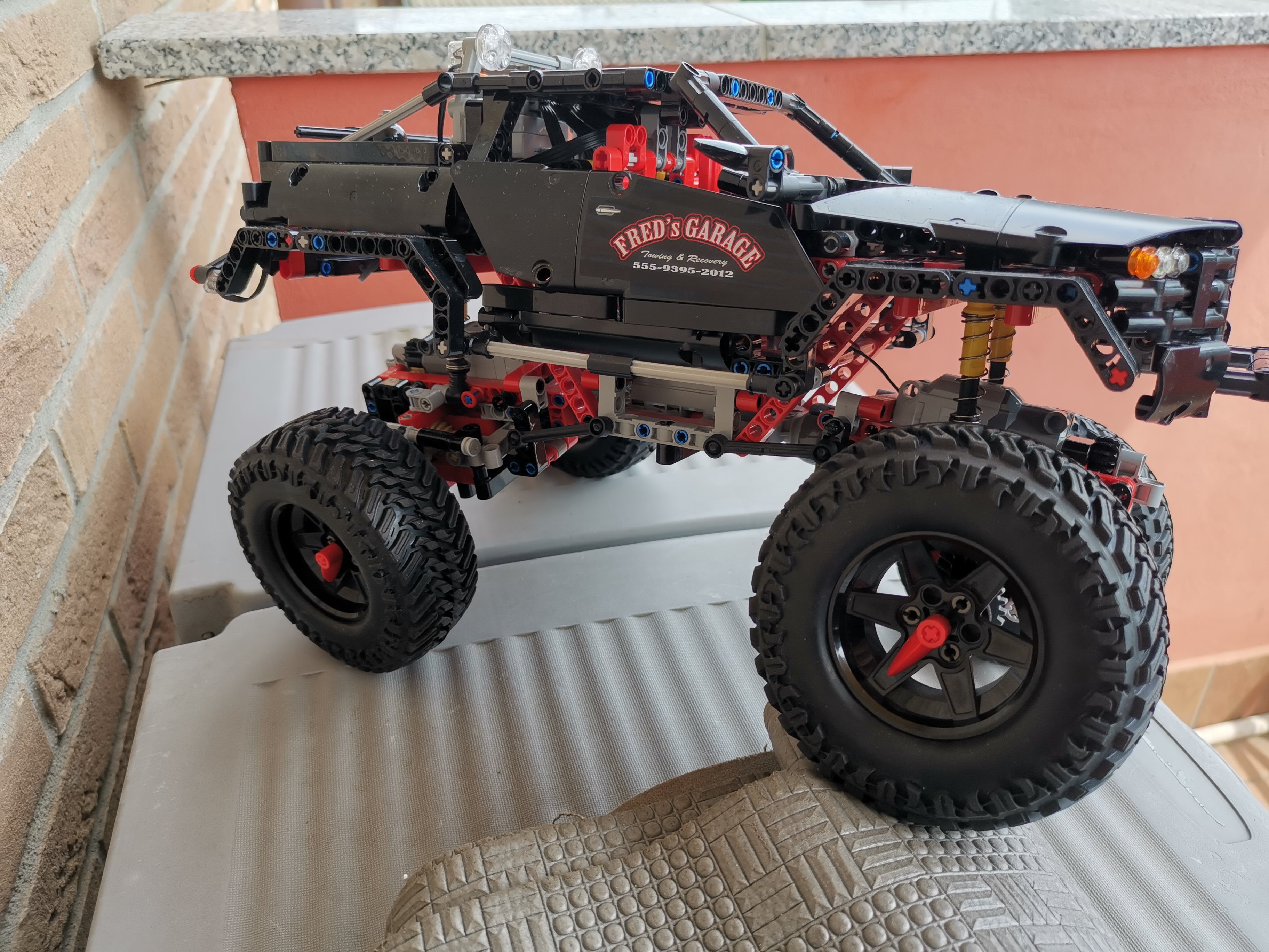

This is my version ... I only changed the 8/24 hub gear, at the moment I use the 8878 battery but I would like to mount its original 9v. I would like to remove the differentials, does anyone have any photos or a file where you can see this change?
Edited by RichTech
