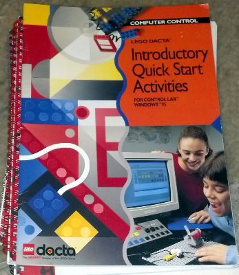

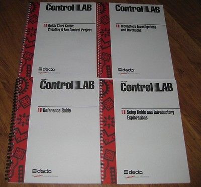

I'm also looking for the original manuals/guides of the LEGO Control Lab software but without luck so far :(
Here are the photos of them on Internet:
CLAB_GUIDES1.jpg.a63642785b48137a30dff684384e2b98.jpgCLAB_GUIDES.jpg.4baa58bb52876d635f4ed580e6afc815.jpg
If someone have this guides, please share with us :)
