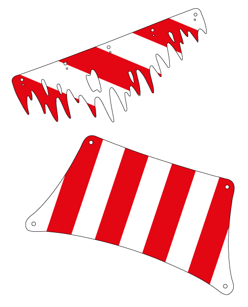

I just made vector versions from all the new sails. Israel, would you be interested in hosting/merging my files with your collection?
I also combined the new sails with the tattered look from 71042 Silent Mary. It also lets you mix and match, depending on whether you want the shorter or longer tattered sails on either the top or the bottom rigging. There's also a version for the bow. You can find both PDF and Illustrator files over at my Bricksafe: https://bricksafe.com/pages/DavidOrtmann/pirates-of-barracuda-bay
Let me know if you have any feedback!

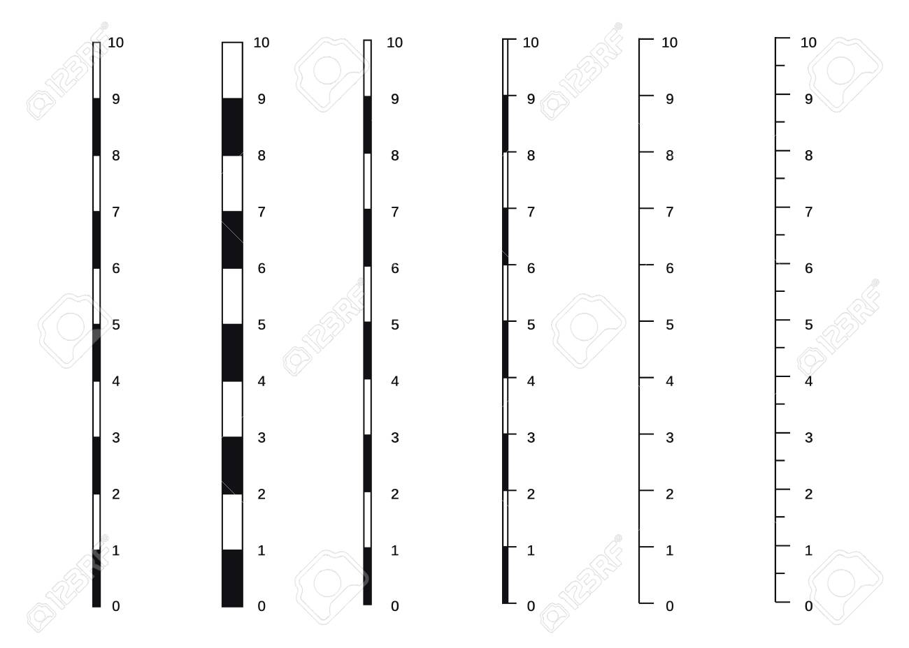

Alazon would it be possible to include a scale rule on each print, 5 cm or 10 cm to help with scaling when printing. One of these sort of things
Map Scales Graphics For Measuring Distances. Scale Measure Map ...

My sails are 100% scanned and vectorized from the new Bay sails! The tattered sails are matched in size for the bay.
I'll gladly change the outline and add a ruler as you proposed. I will print the tattered sails today and take a photo tonight!

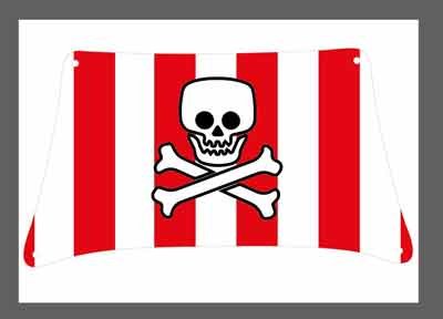

I mean this logo:
49787761988_a7a0b378e7_o.jpg21322_Box3_v29 másolat by Gyula Herr, on Flickr
It would be great to have it in vectorized form. I'll try it on one sail.

Like this?:
I'll upload it to my Bricksafe in a few seconds. If you have any other wishes or want to have a go at it yourself, drop me a line or use the vector files! There's a pure black and a white version (with outlines, as seen above) available.
Yes, that is what I plan to do. Maybe I'll give a try to the torn sails as well.
