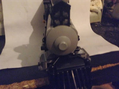

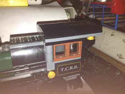

I've done some Mods to the Lone Ranger Train Chase to make more like a Steam Locomotive, for which I wished they done it a little more better on it so here's the Mods I've done for it.
All Photos were taken from iPod Touch 5th Gen
Here's what I did
  • Revised the Front to have a Satellite dish and a 1x1 round flat tile
  • Made a simple drive rod (for until I make my own full pistion mod)
  • Revised the Roof by removing the 1x2 with sticks on them
  • Removed the bricks that snapped under the roof (Original Model didn't had them)
  • Added in Four Windows in the Frames
I love it how I did this to bring out a Locomotive with my own Taste of Modding here.

You're quite welcome I've always wanted to make it more like a Locomotive, still trying to make a working Piston system for it while keeping the two front wheels

I did created on one point to move the two coupling plate and remove the brick that held the wheels out and used another plate to stack that up then I used a 2x3 and stick one under the 2nd couple plate then put 1x2 white plates and snapped that under here it holds the main driver wheels itself on the front of that. I taken a picture of it once but I'm scrapping the original Idea I had for it.
