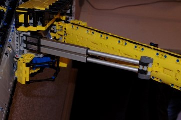

Alex/afol69: I have finally got some more time to test with the Firgelli actuator. There is no doubt that one standard geared actuator can't lift the boom. I did mount one alternative geared actuator and it can lift the boom ad that should give the result that 2 standard geared should also be able to do it. However when I have demonstrated the crane you could hear that the actuator was really on work so now I have tested with 2 alternative geared actuators and it sounds a lot better. For me I will keep it with 2 alternative geared actuators.
Then I better get back to the plans for LEGO World in Copenhagen.

Hi Alex,
I did purchase my second standard actuator from France but it was out of stock at that time and I needed the crane to be ready before LEGO World in Copenhagen. To be on the safe side I ordered 2 with the alternative gearbox from Canada. They actually arrived before the one from France and they had been so kind to put in 2 extra gearboxes so I can change on my standard ones if needed.
When 1 alternative geared can lift the boom it should mean that 2 standard ones can do it also but to be on the safe side and not crash my gearbox I prefer to use 2 alternative geared.
