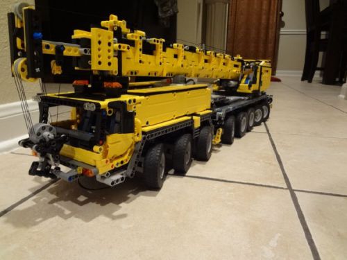

looking at your pictures I noticed that you have a realistic looking wiring setup of the hook (multiple pulleys/wires vs only 1). Would you mind posting a shot that shows better that area of the build?

Hi Nerdsforprez,

I'd be interested in seeing this also. It looks so much better.
Sorry guys...... just getting around to seeing this.. what exactly would you like additional pictures of? I can try to get the pics when I get home, but to be honest with you it may take a while. I am in the process of moving my family in the next month and therefore we are slowly packing bit by bit. Although I have not yet packed by LEGO models my cranes cables (string) came undone when I had to move it from my office. I can re-string it... but it takes time. I will say this..... in one aspect I used modified parts. The pulley system only works if the pulleys are bored all the way through.... (no axle hole). This allows the pulleys to move at different speeds and therefore leads to the enhanced lifting power. So I bored the Technic wedges
http://www.bricklink.com/search.asp?colorID=1&itemID=823
with a drill. I know Efferman offers these pieces (bored hole) on Shapeways but I thought I would just make the part myself. I did this to mimic real cranes, and tried to lift a modified 8070 at around 1300 grams. Even with the pulley system it did not work.
One of my first projects after I move will be to couple two L-PF motors together to increase the lifting power and fit them into the superstructure. I want the crane to lift the 8070!!! I will post it when it is all done but probably will take a while. Lemme know what pics you want and I will try to get them.

which gear ratio ands motor do you have in the winch?
btw, i think you have made a error in the Y-stabilizers. why do you have the liftarms on the extension side where dou you have to change the liftarms at every retracting and extracting the boom?
source
I did this only for the purpose of the lift of 8070. I get that they are supposed to be switched..... however, I was not lifting the boom any and for the purpose of the lift needed the top part more stable than any other part of the bottom part. It is corrected when I present the model.... but again, only for the purpose of the lift I switched them.......
