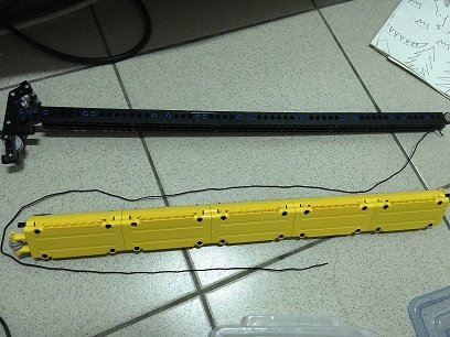

Hi All, I'm currently building the GMK6400, but I'm having a lot of trouble,Section III boom can not be recovered (but can be extended),
And I can not determine whether my string installation is correct?
15 minutes ago, efferman said:
Have you installed two strings?
Hi efferman,
No, I only install one string,Should I install two string?
If yes,How do I install in my boom section 2 and section 3 ?
Thanks you.
efferman
37 minutes ago, efferman said:
One string is extracting the boom, the other one is retracting the boom. So you need both
Got it, but the instructions does not specify the string where the fixed, there is a detailed picture can refer to it?
Attached is a diagram for routing both cables to have extend and retract.  I have used this to great success.
Edited by nychase
Hi,Nychase, This is really a very useful solution, I will try to install it, I hope to be able to succeed in my gmk6400,  I am so grateful for your help ! ^^

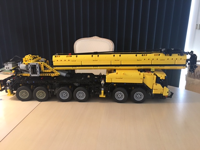

ive been making a couple changes to the design
the cab is now 17 holes wide as well as the fenders and I added a hood over the engine and wired it for an extra switch to turn off the front receivers and added an extra xl motor just for the engine to run i also put efferman's superstructure on and put a switch in the superstructure to turn the winch on the superstructure off
