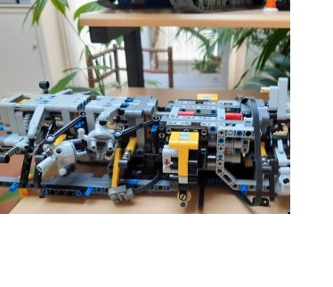

Lego.jpg.65b1537f61ac06f6296b2a46bf5f2d76.jpgHeel erg bedankt voor de reacties, maar gezien de leeftijd en Parkinson, en helemaal niet opgroeien met Lego, staan Technic, hoop ik dat jullie begrijpen dat ik er niets van begrijp, ik heb de bouwinstructies precies gevolgd, dan heb ik ga ervan uit dat alles op de goede plek staat.
Edited by Wilm112
I see on the far most left and the middle axle the small tan gears both on the left, but on the right axle it is on the right. Not sure if it is correct according to the building instructions, but to me it seems that this isn’t right, so maybe try swapping those?
and btw, use english, much more people will try to help you I think (not to offend you or anything) and I totally understand that it is difficult to pick up Lego at you’re age, but no worries, if I can help, I will try to, and I’m sure a lot more people here on EB will.

I just sent you @Wilm112 a direct message (check your inbox here @ Eurobricks). Will try to provide help using direct email in dutch.
