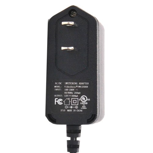

dhc6twinotter Posted February 18, 2012 Author Posted February 18, 2012 Dluders, can you check your transformer and see what the plug layout is? There should be a little diagram with a + and - that shows the polarity of the plug. I found this: http://www.amazon.com/VideoSecu-Regulated-Camera-Supply-Adapter/dp/B000VRL632/ref=sr_1_44?ie=UTF8&qid=1329583172&sr=8-44 It's listed at DC 12V 500mA. It's not 480, so I'm not sure if that would work. I'll look around a bit more. Quote
DLuders Posted February 18, 2012 Posted February 18, 2012 (edited) Daniel, the Lego transformer has the same vertical prong setup, and exactly the same - to + symbols as the one you found on Amazon: There is an "Efficiency Level IV" on the back of the Lego transformer; I don't know what that means exactly but I do know it charges the LiPo PF Rechargeable battery fairly quickly. Here is the Peeron photo of the Lego 8887 10V DC transformer: Edited February 18, 2012 by DLuders Quote
Toastie Posted February 18, 2012 Posted February 18, 2012 Am I understanding correctly that I can use a DC 12V at 550mA transformer from my local electronics store to charge the battery? Absolutely. The amperage rating could be higher (something like 750 mA or 1 A, the more the safer), but is not necessary. Just try it out - the LiPo will not take any damage. Best regards, Thorsten Daniel, the Lego transformer has the same vertical prong setup, and exactly the same - to + symbols as the one you found on Amazon: There is an "Efficiency Level IV" on the back of the Lego transformer; I don't know what that means exactly but I do know it charges the LiPo PF Rechargeable battery fairly quickly. Here is the Peeron photo of the Lego 8887 10V DC transformer: The top one will work for sure! Regards, Thorsten Quote
