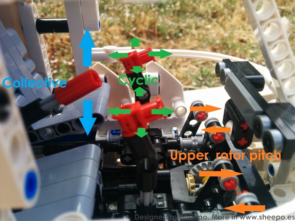

Complete rotors control using two swashplates directly from the cabin. Just like the real KA-32.
Collective lever control: fly up-down
Cyclic stick control(both sticks works): fly front-back-right-left(not turn)
Upper rotor pitch pedals: turn right-left
The controls only control de lower swashplate, and this one control the upper swashplate using the there grey links .

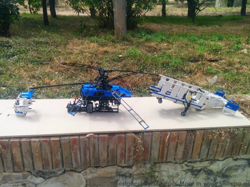

And the rear ones have suspension, and a side sliding door.
Very quick fuselage disassemble.

I built this model last weekend to test the instructions and I must say that I love it. It is huge, technical, and impressive. It is a wonderful way to show novices how a heli rotor system really works. This is a topic that is very hard to convey in words, but becomes much easier when you can see it with your own eyes.
Over the next few days I will be posting some pictures and technical explanations of how the model works. I'll start with a global overview:
The yellow parts rotate in one direction and the blue parts in the other direction. The red parts comprise the 2-axis gimbal which drives the swashplates. When using the red collective lever, the entire assembly goes up and down. When using the green cyclic levers, the swashplate tips either fore-aft or sideways. The orange pedals lift the entire yellow central drive assembly. The white XL motor powers it all. Everything you see in the image are moving parts.
Ruminate on that whilst I prepare the next pictures!
