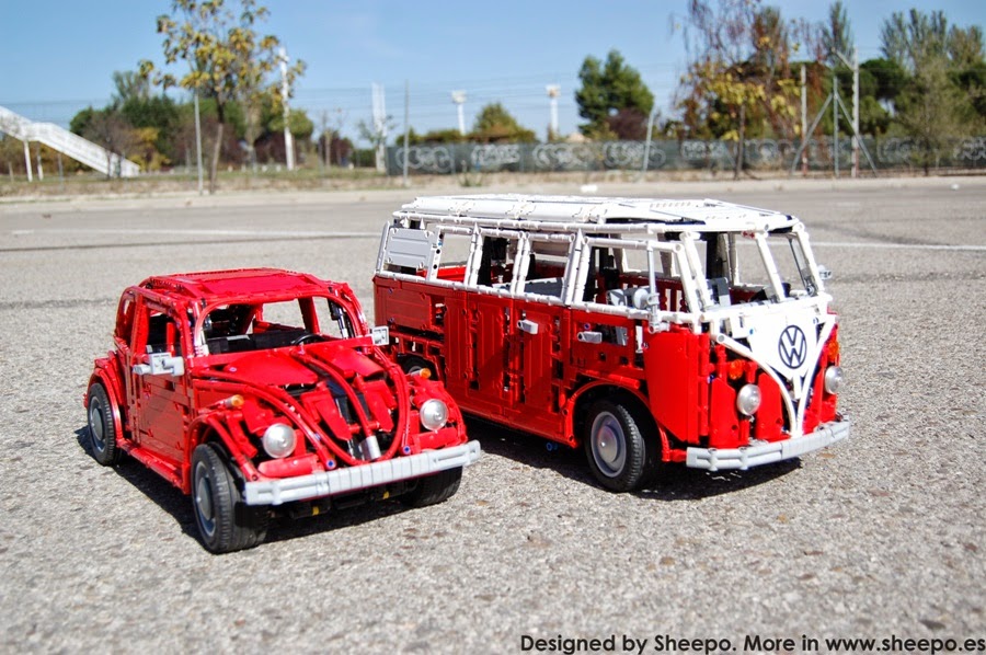

This van officially called "Type 2", is one of the most famous van in the world. Very popular in the 60's and known as the "hippies car"
There are many versions of the Type 2, this one is of the BUS version, known as "11 windows", it is very easy know why ;)
The real one:
It is made in scale 1:7.8. The total size is: 66 studs of length, only 27 wide and 30 of high (53x22x25 cm)

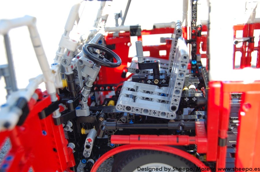

A complete bodywork with openable front doors, right side double door, and rear trunk and bonnet.
Also the doors have lock, you need turn the door handle to open it.
Working steering wheel and brake pedal. Like the Beetle both mechanisms auto-connect when you place the bodywork on the chassis.

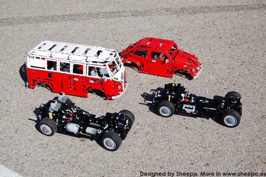

And now the best part: Like the real Type 2, this MOC uses the same Type 1 platform of my previous Beetle (more info here)

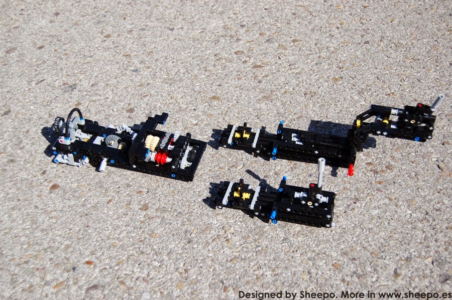

MANUAL chassis on the left, and RC chassis on the right.
The Manual chassis is like you can imagine, 4+R speeds manual gearbox. To use the chassis in the Beetle or in the T1 you only need to change the shift lever
Short fotr the Beetle and long for the T1.
The RC chassis is the same as my Beetle, 4+N+R sequential gearbox, also has motors for drive, steering and brakes
If yoy want to the RC chassis in action the best way is see the complete Beetle video
Like the manual chassis you only need to change the speed indicator to use it in the Beetle or in the T1
Some pictures of the platform-brothers
