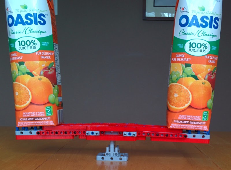

I tried it here, here are the results with 960 mL juice boxes:

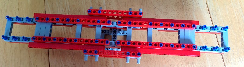

Here is the structure as seen from the top:
The structure should be mounted upside-down from what you see here if you decide to use it.
It still has a bit of flex to it and I don't think you can eliminate it. That being said, it can be reinforced by adding the body of the car. The weak point will be the door openings, but you can reinforce that section with the center console stretching under the seats and by adding another layer of beams at the door openings, just like the picture of the real car shows. I get the impression that the final product can be quite rigid, but not by having a separate chassis and body.
Wow, that structure is really strong and would get the job done.
