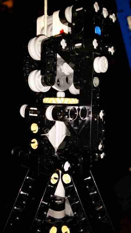

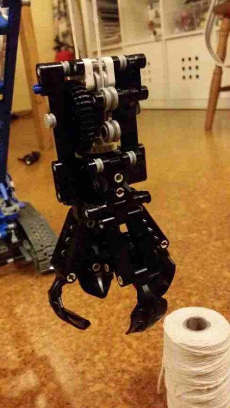

Posted August 6, 20159 yr I really like this set, and even it has IMO a great gearbox, one of the first things I was thinking of after completing the build, was how to make it RC. I guess most of the six functions are straight forward, but operation of the claw is obviously more tricky. I tried to figure out if it was possible to operate the claw by the hoist string. I realized that it is possible to transfer motion to a pulley in the claw simply by pulling the string on one side of the pulley, and letting out on the other side. The claw should then in theory be kept at the same level, and the motion transfered to the pulley could be used to drive the m-LA. To achieve this, I have used two reels, each of them connected to the ouputs of a subtractor (geared down 1:3 with Z12 and Z36 double bevel gears). If using tracked vehicle implementation of a subtractor as a reference, the "drive" part is done with a M motor driving a worm gear that in turn drives a Z8 spur gear. The "turn" part is done by a XL motor, directly driving the differential housings. I probably could use a L motor as well, thus avoid the coasting of the XL. The string I have used, is simple string for packing purposes. I guess it is better (and more puristic) to use the thick LEGO string, as it looks better, is more solid and no twisting. Problem is, can I get a thick LEGO string that is long enough? Please don't judge from the aesthetics, the main goal for me at this stage was to demonstrate the idea, and I have not put a lot of effort in the looks, or making it compact. Link to video: Here is my own judge for the idea: Pros: IMO it looks more clean than a hanging motor with it's supplying wires. Both hoisting and claw operation may be done simultaneously. Able to operate two functions with a simple string. Adding mechanical complexity to the model, something I like. Cons: The torque delivered to the m-LA is limited, so the grip of the claw is not very strong. It should be apx. equal amount of string on both reals, to achieve claw operation without changing the level of the claw. Claw operation is depending on friction between the string and the claw pulley. If the the claw is resting on the ground or the object it should lift, it will not work. Probably not real-life-like implementation of claw operation. Another idea I have, still not tested, is to convert the hoist string into a closed loop. the claw implementation is the same, with a pulley driving the m-LA. On the tip of the boom, there is a pulley, driven by cross axles from the super structure (the reason for location on the tip of the boom is to reduce length of the string, and number of pulleys, to reduce friction). The hoist may then be done by two pulleys pulled along the boom, towards the super structure. One of the advantages of this implementation, if it works, is that "Con #2" above is eliminated. I don't know if this description makes sense to you, I will try to test this version also. Main problem is, how to make a long, closed loop of LEGO string, without any bumps. I appreciate any feedback, including cons. And I also hope to inspire some of you to come up with a better solution. PS: Somebody who knows how to embed a "visual" youtube link, like most of the others do (I didn't figure out)? Edited August 7, 20159 yr by Alasdair Ryan

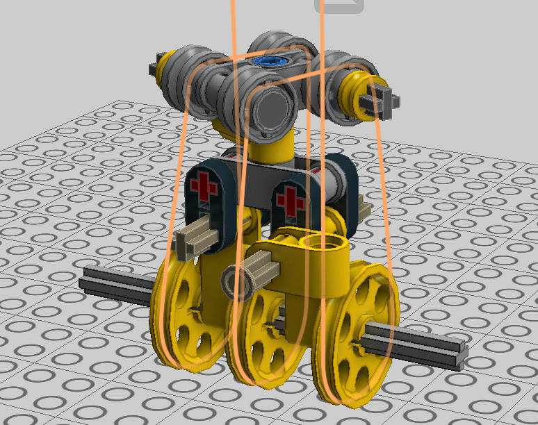

August 7, 20159 yr Author That's really clever... Maybe adding some thin rubber tire to the spool will help to increase the friction? Something like this: with some guiding elements around it to make sure the string doesn't fall off. If you remove the s from https your videolink should embed (and maybe you'll also have to add before and after, I always forget) Thanks for the feedback! Here is a few pictures showing some more details: Her you can see the pulley (3L diameter) and 6 small rims (the same as your posted picture, only without the rubber) to keep the string in place. the two uppermost pulleys (you see only one of them) are there for securing the string, and also to make distance between the entrance and exit of the string. This to avoid too much rotation of the claw, and also twist of the string. The claw pulley is driving a Z36 double bevek gear, which in turn drives a Z20 bevel gear, driving the m-LA. If I understand you correctly, you suggest to use rubber on the pulley to increase friction, and thus the torque transfered to the m-LA before slipping? Perhaps it is possible to use two 3L diameter pulleys with rounded rubber tires (the same as the front wheels of the 42033 Record Breaker) tightly together, and place the string in the groove between them? That will certainly give a lot of friction.
August 7, 20159 yr Thanks for the feedback! Here is a few pictures showing some more details: Her you can see the pulley (3L diameter) and 6 small rims (the same as your posted picture, only without the rubber) to keep the string in place. the two uppermost pulleys (you see only one of them) are there for securing the string, and also to make distance between the entrance and exit of the string. This to avoid too much rotation of the claw, and also twist of the string. The claw pulley is driving a Z36 double bevek gear, which in turn drives a Z20 bevel gear, driving the m-LA. If I understand you correctly, you suggest to use rubber on the pulley to increase friction, and thus the torque transfered to the m-LA before slipping? Perhaps it is possible to use two 3L diameter pulleys with rounded rubber tires (the same as the front wheels of the 42033 Record Breaker) tightly together, and place the string in the groove between them? That will certainly give a lot of friction. I just realized that my example will require an axlehole in the wheel and not a pinhole , so yeah, having two 3L pulleys with tires will be a better solution. Just make sure that the rope is thick enough so that it doesn't slip inbetween the two pulleys.
