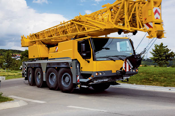

Because of these issues I am strongly considering changing the scale and crane model to the Liebherr LTM 1070-4.2. I was never satisfied with the carrier from this crane which is why I moved to the superstructure so this is a good opportunity to change to a completely different carrier with a similar superstructure, just a little bit narrower to fit the scale. Your input into what I should do would be appreciated :classic:
What scale the new carrier will be? Unless you make it much smaller, your boom issues wont be solved.
Also, arguably, pneumatics are not good aproach for a boom this size. You need something that wont be able to compress under the weight.
What you can do without adding more counterweight, is to move boom and actuator more to the back, relative to the turntable, until it is balanced.

That's the key to it Erik. Milan, I'm thinking around the 1:23.5 mark because I saw a MOC of a very similar crane to the one I plan in that scale because the wheels are larger. I'm hoping on solving the boom issues by making it only one stage extension by removing the outer shell and making what was the first stage the new outer shell. This will remove quite a lot of weight and make the boom diameter more to scale. I thought on pneumatics because you can easily link two together end to end to get a longer ram but as you say the problem with using air means that holding it up is nigh on impossible, I went to the end to end pneumatics because two large LA's lifting the boom in parallel were unable to lift the boom due to the tiny range of motion at the base of the boom. The boom and actuator are already mounted behind the turntable and moving them any further would make it look terrible so we'll see where we end up from that problem.
At the moment I'm working on building the new carrier chassis, building the four steering, driven axles which won't feature suspension. I will get the multiple steering modes through using two Servo motors, one for the front axles and one for the rear axles. That way I can get counter-steering, crab steering, rear steering and front steering.
