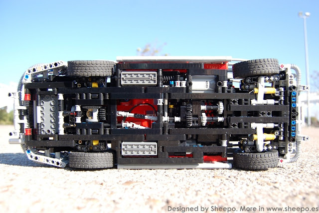

Realistic suspension in both axles: double wishbone in the front and swing axle in the rear.
Well, many people asked me about if the scale change from 1/8 to 1/10 will reduce the functions of my cars, and I told them that will not happen, I think this car is a good example.
Small size car doesn't mean poor functions, here the first proof: 4 speeds sequential gearbox.
In this car I release a whole new gearbox, 4th gen. It is very small and very very reliavable. In this car it doesn't include auto-stop function for gearbox motor (PF M motor), so you must stop the motor by yourself.
Of course it include speed indicator from the interior of the car.
And the second proof: drum brakes in all wheels.
Yes, brakes like my other big cars. In this time to save some space I have used the interior side of the rim like the drum. Powered by a M motor.

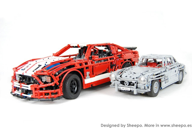

Finally a picture to show you the real size difference between this 1/10.5 scale car and one of my previous 1/8 cars.

Another great model man :) ive used more or less the same drum brake setup in my old lancia fulvia! Did u manage to add it to front wheels as well?
THanks for your comments!!
It has brakes in all wheels, you can see it in the video at 1:25.
