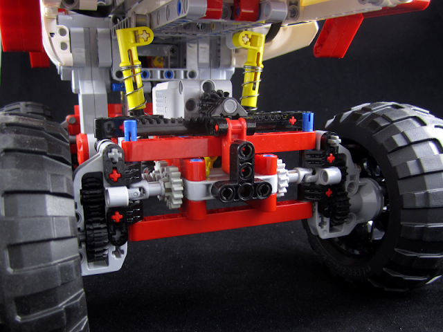

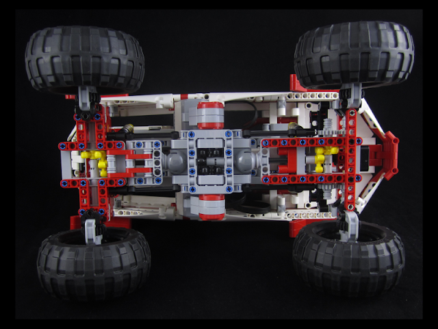

BusterHaus Posted December 26, 2015 Posted December 26, 2015 (edited) I made this topic to group my creations in one place. I won't bother reposting stuff that has its own discussion threads already, just new projects. 1) EV3 Trial Truck V2 I built another Trial Truck controlled by EV3 components. There was no programming involved in this project. The truck was controlled by the Lego Commander app via Bluetooth. The Controller Brick sits in the back of the truck while two Large Motors power the drive train. The power is transferred through knob gears to portal hubs. There are no differentials (like in the last Trial Truck) because their outdoor performance is not that great. Steering is done by the Medium Motor. Both axles feature a pendular suspension. The drive train has a weak spot where the motors drive the shaft - the 5x7 frames can pop apart when there is too much torque being transferred. There's space for additional bracing, but I discovered that a gradual acceleration helped resolve the problem for the most part. The truck isn't really a looker, but performs pretty well. The suspension works well and the drive train is pretty strong. I was worried that the center of gravity would be too high because of the location of the Control Brick, but that turned out to be a non-issue. Here is a short video of the Trial Truck in action: Edited December 26, 2015 by BusterHaus Quote
TinkerBrick Posted December 26, 2015 Posted December 26, 2015 Looks good and performance wise it is more than acceptable. Those Mindstorm servos seem really powerful. Quote

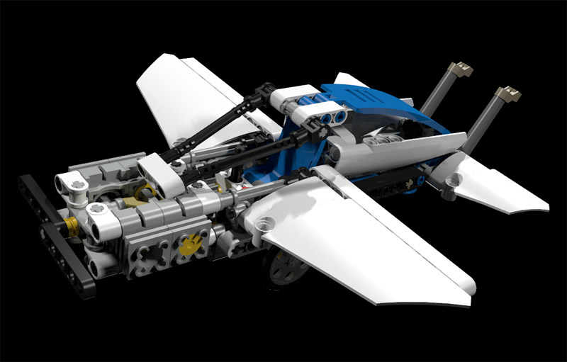

BusterHaus Posted March 18, 2016 Author Posted March 18, 2016 (edited) Here is a C-Model for the Technic 42045 set. The small sets turn out to be more challenging for C models, as the part count is rather limited. Instructions are available by clicking here. I used LDCad to make them and it left me with a good impression. The final stepping and rotations were done in MLCad, and the layout was done in a PDF editor. The layout is pretty efficient, but is rather time consuming. I'm not sure if I will use it in the future. There is a small mistake in the instructions - they ask for two 5L half-beams for the propellers, while the set comes with 4L half-beams. Edited March 18, 2016 by BusterHaus Quote

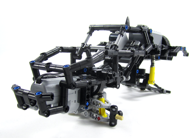

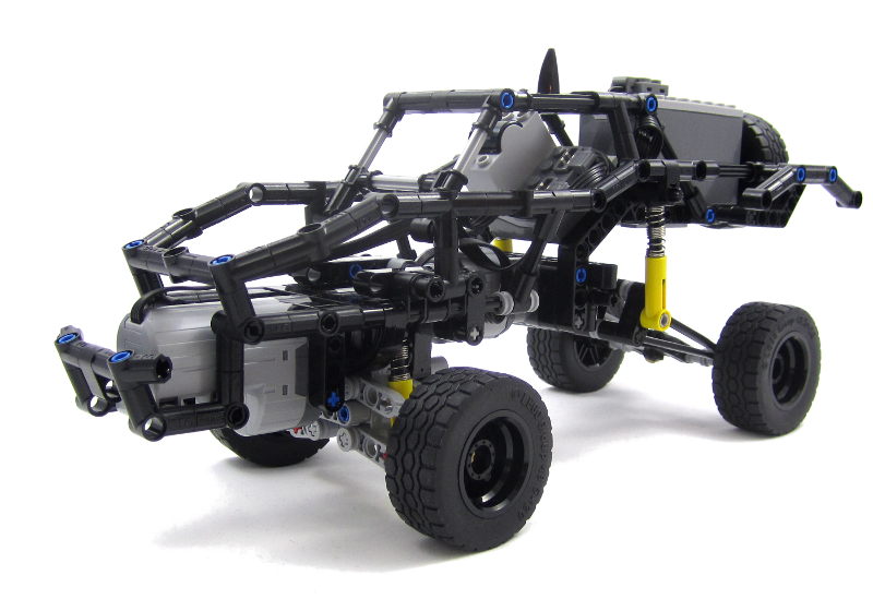

BusterHaus Posted March 27, 2016 Author Posted March 27, 2016 (edited) 1x L-Motor for drive, 1:1 gear ratio 1x Servo Motor for steering 49.5 x 20 tires Weight: 490 grams with batteries Full description. Edited March 27, 2016 by BusterHaus Quote
grum64 Posted March 27, 2016 Posted March 27, 2016 Light, strong and fast. What's not to like. Great work Bart. Quote
BusterHaus Posted March 27, 2016 Author Posted March 27, 2016 Thank you Edwin and Clive. I'm quite happy with it, I think I'll build something larger for my next project. Quote

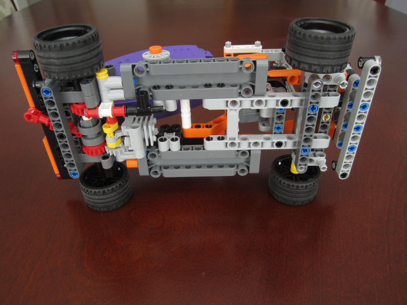

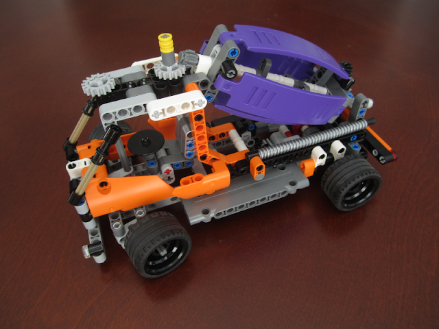

BusterHaus Posted September 4, 2016 Author Posted September 4, 2016 I turned a Race Kart into a Cement Mixer. This C-Model for the Lego Technic set 42048 has the following functions, best seen in the video below: Steering Internal mixer External mixer Fake engine Neutral gear Parking brake Cement spreading pipe The lack of bevel gears in this set made perpendicular power transfer virtually impossible. The mixer is powered at an angle but the 8 tooth gear has to be placed properly for it to work. It doesn't slip, but it's not my favorite way to build. There are also at least two illegal connections: the steering axle is slightly angled and the parking brake is made by applying pressure to one of the red gears. Both functions work, but hacks like this put unnecessary stress on parts that is not desired in the long run. Left over parts: Quote
Edwin Korstanje Posted September 4, 2016 Posted September 4, 2016 I like this out off the box thinking C-model Quote
nerdsforprez Posted September 4, 2016 Posted September 4, 2016 I have always thought that C models are a little unappreciated. It is very difficult to build out of limited number of parts. Your project is great. It should be added to the C model thread Quote
syclone Posted September 4, 2016 Posted September 4, 2016 Wow,great use of the new panels! And you even have leftovers, amazing! Quote
grum64 Posted September 4, 2016 Posted September 4, 2016 What a great C model. It's a big leap from Race Kart to Cement Mixer Quote
ScaleCarModels Posted September 4, 2016 Posted September 4, 2016 Nice builds, the tubular truck is cool love your design. For some reason it looks like something Batman would drive. Quote
z3_2drive Posted September 5, 2016 Posted September 5, 2016 Never would've thought a kart could be transformed into a mixer! Excellent work. Quote
