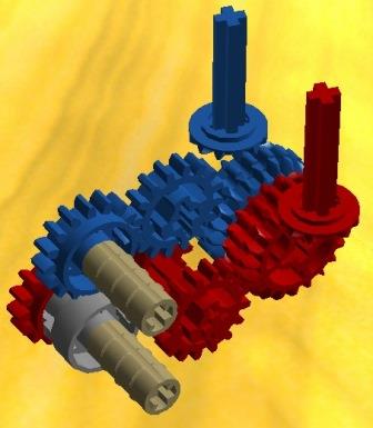

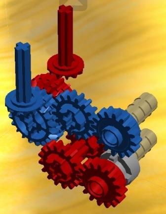

The model has an L engine with a transfer case.
The biggest challenge in the construction was limited space for the transfer case, because most of the space in the bottom of the battery pack occupies.

Instructions are unlikely to be able to do, because telehandler I already dismantled...

All distribution box can not remember ... But I can show the basic idea, which helped to save space:
