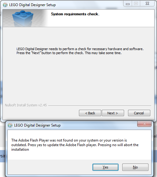

"adobe flash player activex required" version 4.3 really annoying. there's no such thing since one can only download adobe flash player for a browser rather than the computer, and i looked everywhere
Why did you “looked everywhere” to install that component? Just click “Yes” in the dialog box and LDD Setup will download and install what it (says it) needs.
I'm having the same problem, and no, letting LDD try to install the Flash component fails as well. I've updated the Flash player in both IE and stand-alone mode, but LDD still won't install. I'm currently stuck in 4.3.8 and can't download new bricks.
EDIT: Found the fix! Open Internet Explorer and update Flash within that browser. Turns out I never did it properly, but LDD installed no problem after updating Flash in IE.
Edited by icarusbird
Sorry no offense at all but i dont think you get it. I "looked everywhere" to install the adobe software it was asking for. I couldnt click yes/next, as you can see the screenshot
Thanks icarus!! :) Thanks to you too sylvainls. And sorry my username is random words, im not good at usernames
