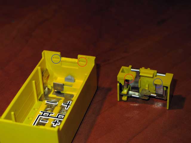

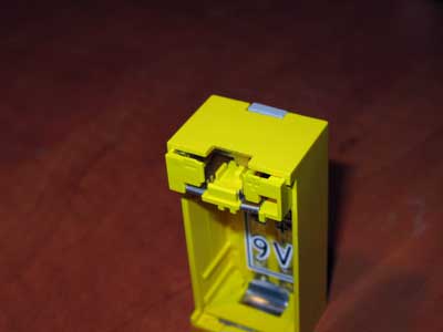

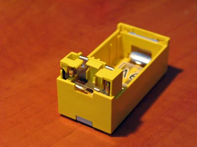

Hey there!
Too bad there's a leak in your 9v battery case.
Your question made me curious about how to disassemble it.
I fiddled with mine for a bit and took the metal connectors inside that are under the power switch/
I guess what's causing the problem with your battery box.
It's fairly easy to seperate - just don't use your nails! :)
Here are some images, hope they explain how the bit with the metal connectors is held in place - just two "snaps".
What i did is try to flex and expand the box casing and pull the small bit out.

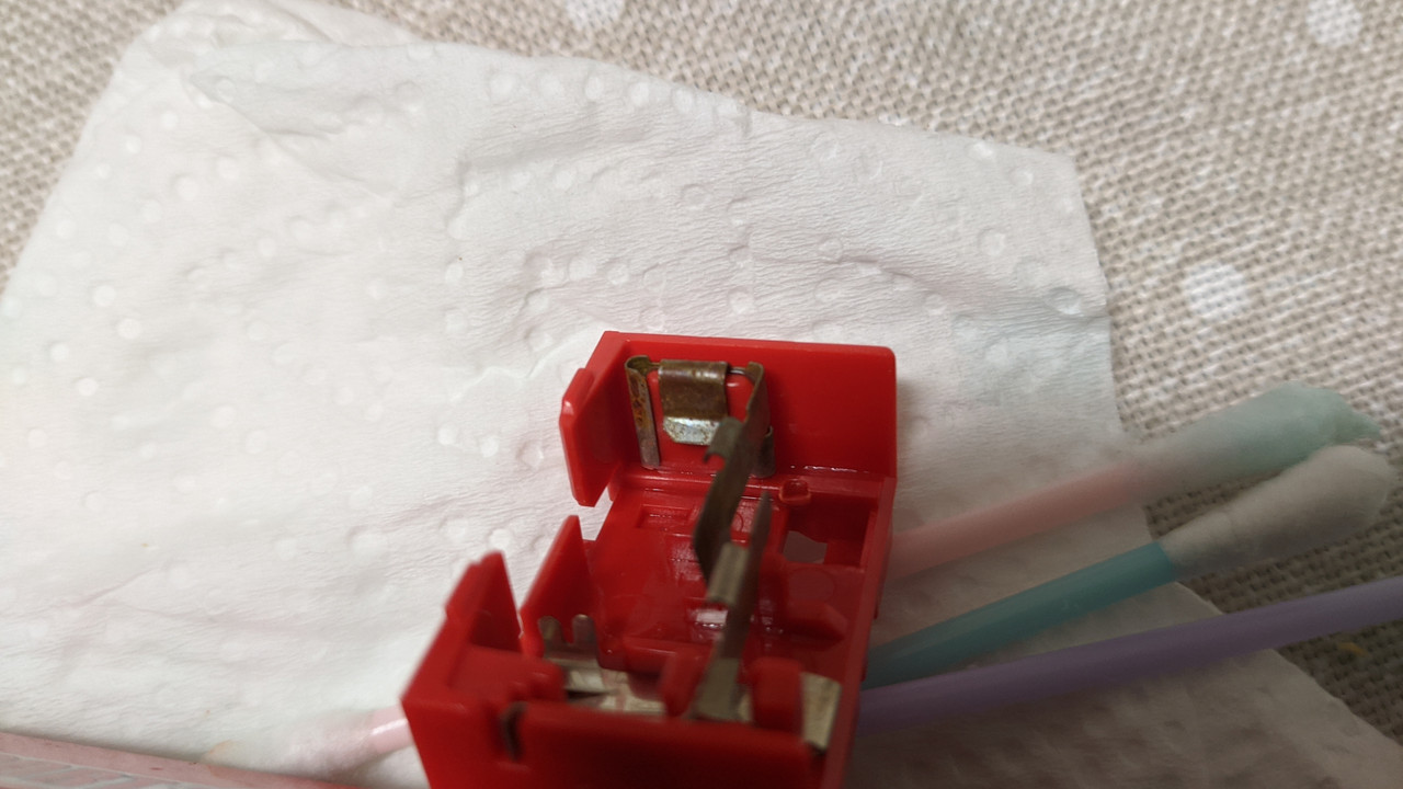

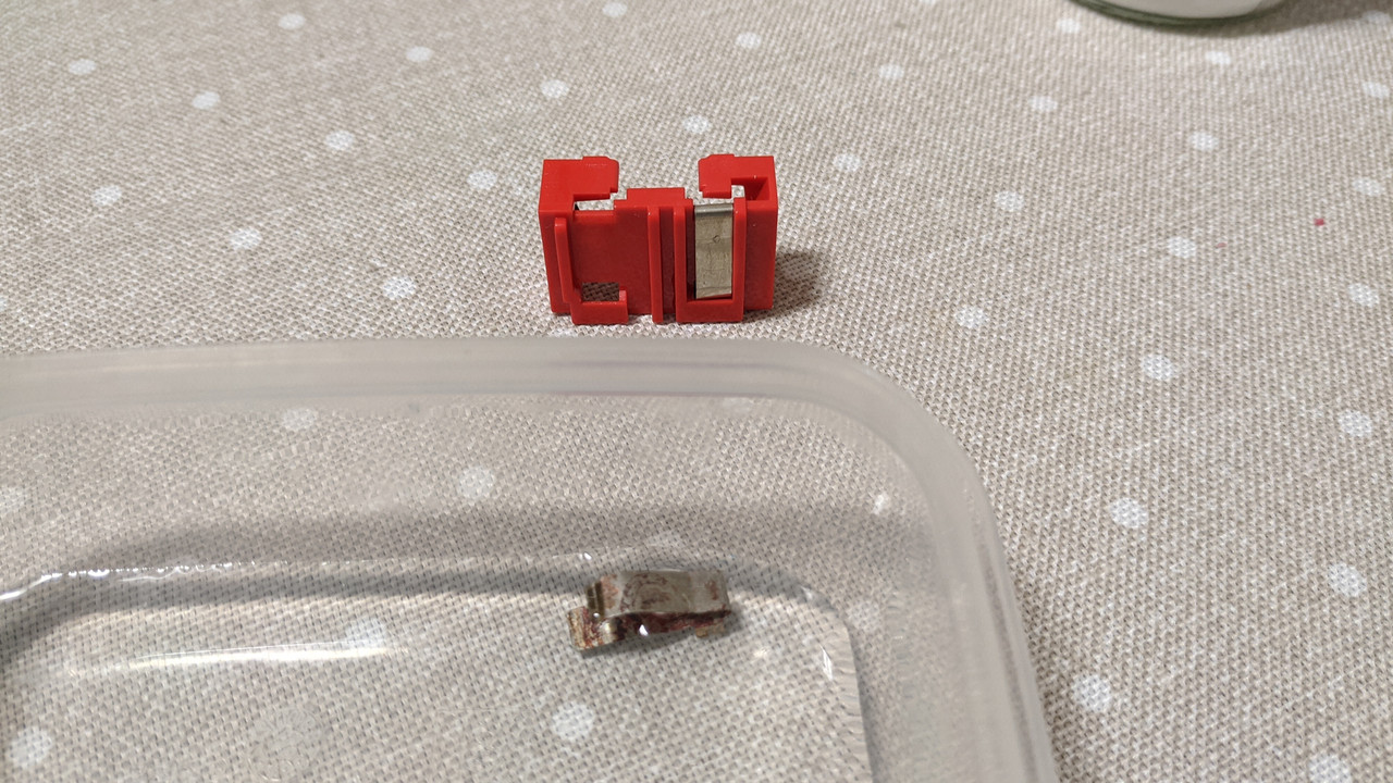

Sorry to bump an old thread, but I want to add that you can also remove additional metal connectors:
Also, the metal connector on the right side of the "small bit" can also be removed, VERY gently pry it off by wiggling it a bit:
Hope this helps someone.
