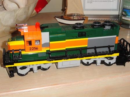

OK, so I finally got around to taking some pictures of my BNSF MOD. It is still incomplete, but I should have the final parts from BL later this week. Here is one pic showing the general arrangement of the PF set up.
Looks good, just one question:
Why not move the IR Receiver back 2 studs to fully enclose it in the 4-wide bulge?
The bulge is only on one side, and its not a full stud "bulge". The train is 4.5 studs wide there (uses 1x2 plate with 1 stud jumpers to move it out slightly).

Nice mods to the BNSF so far. :classic:

Your shunter looks great, and its nice to see someone else taking the same route to cover up the battery box. I also worried about offending the purists by use of decals...

OK, update time.....
I got the Papilo white vinyl sticker sheets. It did seem a bit thick at first, but that was mostly the paper backing. Once I peeled off the sticker, it is about the same (possibly slightly thinner) as regular (paper) sticker sheets.
The stuff is pretty cool...it is flexible if you need to bend a corner. It doesn't tear. It takes inkjet ink very well. I am impressed with it. I have my decals for the BNSF MOD getting coated with the clear coating right now...I hope to have it done tomorrow.....matching the colors is a whole other story.
