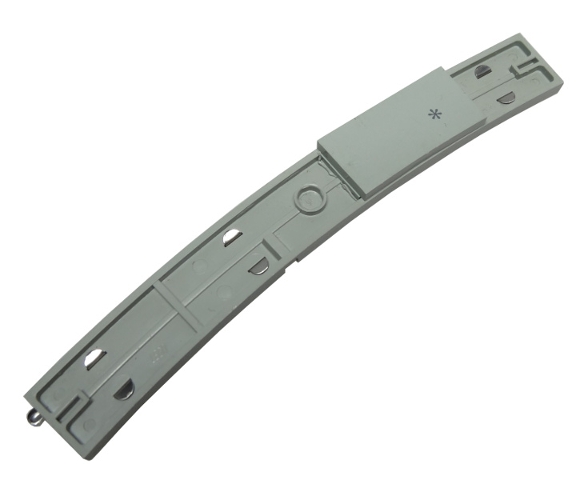

I have two of these:
And there are several for sale on bricklink. What use are they exactly? Google doesn't help :(

It probably has a spool in order to reduce interference with other devices as much as possible.
Interference from the track to other devices or the other way around? And (how) does it 'help' the train?

I think that there is a capacitor in there. They are intented to be used in a large track, to remove high-frequency fluctuations in the voltage.
Most DC motors come with a small capacitor attached to them (to remove the voltage-fluctuations produced by the DC motor). Older motors often do not (e.g. the old 4.5V technic motor has no capacitor). The 12V train motor does not contain a capacitor, that's perhaps the reason that lego made a track piece that has a capacitor.
If you don't have these pieces, I would see no reason to buy them because I haven't noticed any difference, with our without a capacitor. But whether it makes any difference or not, you might as well use them since you have them anyway.

Sorry to bump an older topic, but I have recently bought one of the interference free track pieces for which this topic was created.
The piece really works! I keep my 12v layout in a small room that also contains a radio. My radio still uses an aerial to receive the signal. I keep buying more and more track to extend my layout and when I got to a certain layout size (the one from the 7777 book with the bridge) I noticed my radio signal got disrupted, especially when I ran my three trains simultaneously on the same track. After fitting the interference rail near the radio the disruption was greatly reduced. There's still a slight crackling noise, but at least I'll be able to hear the music again... :sweet:
