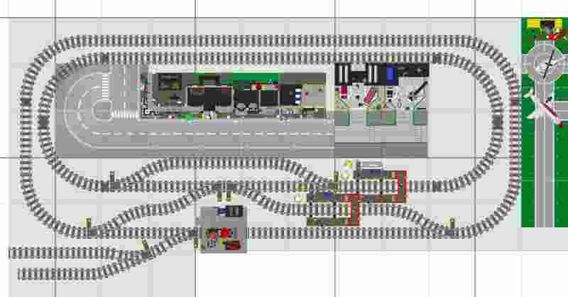

I am currently planing a small train layout as you can see in the attachment. As I am new to this I have following questions:
1. What do you think in general about my layout. Du you have any suggestions for improvements?

In your layout, several track sections and sidings are quite short, so that the trains (like the Emerald Night you included) stopping at the station block another track and no other train can pass – I think that will get annoying pretty soon when running the trains, so you might want to remove the two straight track pieces on the bottom left and left of the center in favor of the station.
For track end buffers have a look in this topic.
I think your layout is trying to do too many things at once. The tracks in the station and the freight yard are so short that a parked train block other tracks. My advice would be: think 'less is more'...
Hi *,
many thanks for your help and suggestions. The issue with the short tracks was also on my mind. You are right - I have to rethink several sections of the layout.
A short explanation why the layout was as it is in the first place: my goal was to fit all my trains and city stuff on the layout. The problem here is that my space is limited as given in the picture. But with you suggestions I identified some workarounds to solve the problems with the short track sections.
I'll update you soon on my progress.
Thanks,
tmctiger

Hi all,
I took your considerations to my layout and started too redesign the whole thing. I finally came up with the following layout I would like to share with you. I would like too hear you comments on this one?
2 remarks:
1. The train station isn't placed as it is shown on the layout. I did a rebuild on that so that it fits better in the track. It now covers all three track lanes. (Photos will follow)
2. I am aware that the fire and police stations generate some problems with the trains. In the final layout I'll move them some studs in the direction to the street so that the trains can pass without any trouble.
