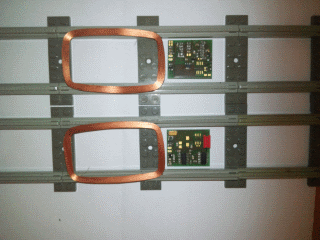

picardgk Posted August 15, 2012 Posted August 15, 2012 This is my first experiment with RFID based train tracking. The goal is not just detecting if a train passes by, but also identify the locomotive, possibly even the carriages. This first setup was just for verifying if the RFID reading is even possible in this scenario. Checking if multiple readers interfere with each other and also don't detect trains from the neighboring lanes. So I setup three readers with standard track spacing. All of them are power with 5V, but only one of the reader is actually connected to the USB serial adapter (because lack of multiple TTL serial adapters) I was using RDM630 based readers with EM4100 RFID tags. The test was successful. I got the best results if I put the tags on the very bottom of the trains. There is no interference, but the reader does miss tags when the train goes too fast. Next step will be to add an ATtiny microcontroller for each reader and use a single I2C bus to collect all the sensor information from the layout. The same microcontroller could also handle LED signals and possibly other sensors. I was think adding an optical reflection sensor for the cases when the RFID is missed. Any ideas are welcome! Quote

picardgk Posted August 16, 2012 Author Posted August 16, 2012 Thanks for the feedback. I was also afraid of the motor magnetic field, but it didn't seem to have effect on these 125Khz RFID tags. Hopefully this will be also case when I switch to DCC with PWM motor signals. Just in case I may follow your advice and move the tags away from the motor. This RDM630 reader uses 9600baud UART TTL output with about a half second latency once the RFID tag passes. I'm not sure why the big latency, but in the meantime it can start reading the next tag. I would like to avoid connecting tons of UART cables to the command central, so my plan is to use a single bus (S88 or I2C). This is why the ATtiny chip for each reader (plus the additional free GPIO pins which I can use). The car identification is only useful when you have a remote controlled decoupling "station" or decoupling built into locomotive like a pushing out an arm (I've seen a MOC on this forum). It would be cool to have programmable train car rearranging or automatically switching locomotives. Quote

picardgk Posted April 29, 2015 Author Posted April 29, 2015 My project got a little delayed :-) No fully automated trains yet. But so far I have not seen RDIF reader interference. These are short range readers and they are always at least 16 studs away from each other. Although rarely I do have some false tag detection from the neighboring track. On the other hand the 9V DCC signal on the tracks did interfere with the I2C TTL wires which I use for collecting information from multiple RFID readers. I'm working on a more robust communication channel now. I will exhibit my train setup in two month at Fanabriques in France. Quote

AxelW Posted November 2, 2018 Posted November 2, 2018 Dear All, in beginning 2018 i startet also to build up a train traking system by use of RFID. I also posponed my action however during my testing i have also seen the behaviour listed in previous reports with the cheap rdm6300. At the end i choose a larger antenna to get a higher range. Together with an discrete 125kHz detekor ( own design) i was able to extend to a range of approximatly 6 cm (on single antennas) However this leads is the fact i did not decode the Tag ID itself, but this allows me to operate on higher train speed. Since i do not need the Train ID, it works fine for me. Antenna side by side operation will disturbe each single system.To allow operating antenna side by side (see picture) the 125kHz Signal need to be in sync, therefore i use an external 125kHz Signal as master. I did not notice any major impact in case the tag is placed below a 9V or 12V motor(i use 8khz PWM to control the motor). regards Quote
