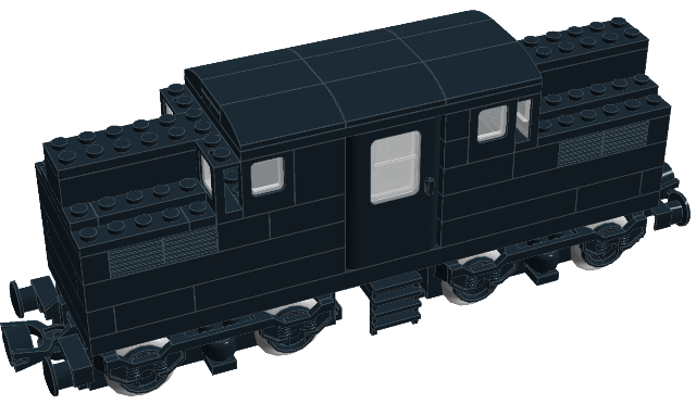

Buzzetta - I don't think you're limiting yourself by building the S-2 Electric in six-wide. It looks symmetrical front-to-back and left-to-right so you might be able to take a modular-style approach by mirroring the front-left with the rear-right and the front-right with the rear-left. (If that makes any sense.) The only tricky part appears to be the wheel arraignment. Are you looking to motorize this via 12V, 9V, or Power Functions?
Here's a verrrrrry basic design using LEGO Digital Designer:
The front and rear are different due to trying to get the roof design to work. The rear design works better but the proportions seem off. Anyway, hopefully it gives you a place to start and I can't wait to see your much better design! :classic:

These are some excellent ideas. I want to mention that my absence does not mean I am not monitoring what you have all written. It is hard to get over here during the work week. I was toying around with a design similar to this but thinking of offsetting the doors with jumper bricks and build the doors as it gives the appearance of a sliding door. The wheel arraignment may pose problematic using a 9V motor. (I do not have a 12v motor or track but may consider buying my first power systems set as I am still a holdout) As an easy solution to the 2:4:2, I was thinking of a non powered engine and placing a motor in rolling stock or a passenger unit. I will have to make a few concessions though due to part availability, design and my building ability when it comes to the details around the wheels.
