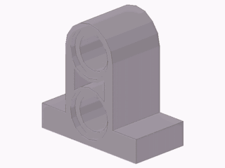

Technic pieces can also be handy, like these:
