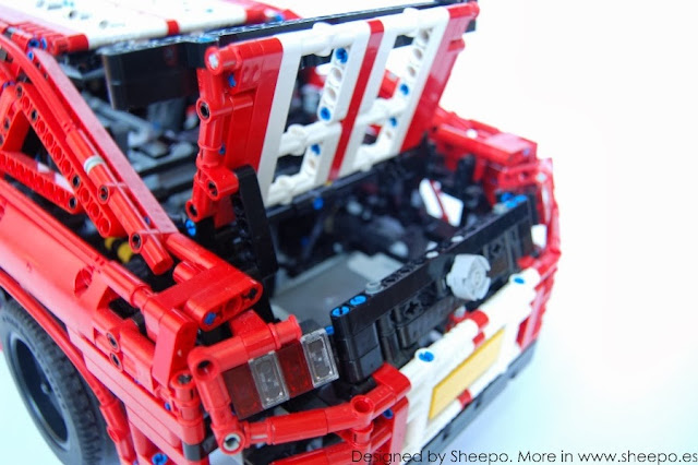

Sheepo Posted October 14, 2013 Posted October 14, 2013 (edited) This is the car I showed in the Lego Fan Weekend two weeks ago. This creation is made in scale 1:8. The total size is: 75 studs of length, 29 wide and 21 of high (60x23x17 cm) The weight is 3.1 kgs, with around 3500 parts and 5 motors. It includes some remote controlled functions: - Steering (M motor) - Drive (2 L motors) - Sequential gearbox (PF Servo motor) - Disc brakes (M motor) The sequential gearbox is an improved version of my previous Caterham ones (3rd Gen V2), with 5+R and auto-clutch. The speeds ratio: R - 2.08:1 1 - 1.67:1 2 - 1.25:1 3 - 1:1 4 - 1:1.33 5 - 1:1.67 The max speed in 5th speed is 3 kph (~2 mph) It has a gear indicator in the interior, between the front seats. For make more easy the gearbox tests the car in has a rear support to keep the rear axle lifted The suspension is based in the real one: front McPherson axle and a rear 4-links live axle. The front axle also has advenced geometry: Camber angle(2º), caster angle(3.5º) and kingpin angle(7º) The steering has ackerman geometry and working steering wheel. The car also has working disc brakes in all wheels, they are very powerfull and includes functional brake pedal. The complete video COMPLETE INSTRUCTIONS WILL BE AVAILABLE COMING SOON!! As always for more info visit my website: sheepo.es Edited January 13, 2014 by Blakbird : Fixed video link. Quote
Meatman Posted October 14, 2013 Posted October 14, 2013 Fantastic as always! The wheels seem a little small though, but it looks great! A good looking Mustang would be very difficult to replicate and you did a great job with it. Edit: The wheel size look great in the front, but a bit too small in the rear. It could just be the photo angles. I like how you replicated the Cobra emblems. Nice! Quote

Splat Posted October 14, 2013 Posted October 14, 2013 Nice work again Sheepo I have to agree that the wheels do look just a little bit small at this scale though. Quote

Rishab N Posted October 14, 2013 Posted October 14, 2013 Another amazing project! However, I also have to agree that the wheels seem too small Quote

Sheepo Posted October 14, 2013 Author Posted October 14, 2013 Thanks to everyone! About the wheels all of you are right...or more or less. The GT500(actually all Mustangs I think) has the rear wheels bigger than the front ones. In the front has 65cm of diamenter and in the rear 68cm, if you take the MOC tyres (81.6mm) and the scale(1/8) you get that the car has an equivalent of 65cm of diamenter. So, the front wheels are in the exactly size, and the rear ones are a little bit small. And now, why the wheels looks like they are much more smaller? Good question, but I don't know the answer... I think that this is because the mudguard is a little bit bigger and the space between the wheel and mudguard makes the wheel look smaller than it really is. blakbird, I am sorry but, what do you mean with "Hurst shifter"? I can not understand you... you mean the gearbox shift lever? Quote
Meatman Posted October 14, 2013 Posted October 14, 2013 I think the wheels of the newer GT500 models are 20 x 9.5 all around. I may be wrong though. Many people may go to a bigger tire for drag racing though. Come to think of it, they might be 19 in the front and a bit narrower, so you may be correct. Quote
KirTech LAB Posted October 14, 2013 Posted October 14, 2013 Great model! And what do you think about wheels from 8461? Those wheels are a bit larger! I understand that mounting of these wheels requires the reconstruction of all the rear suspension so it is just idea :) I used these wheels in my Arrow (http://www.eurobricks.com/forum/index.php?showtopic=85128&hl=arrow) and it looks good (of course the front wheels in my model have smaller diametr so the difference is much more) Quote
Sheepo Posted October 14, 2013 Author Posted October 14, 2013 Maybe I didn't write it well, but was talking about the diameter of the tires, not the rims. The wheels 8461 have the same diamenter as the wheels I used, 81.6mm... Quote
KirTech LAB Posted October 14, 2013 Posted October 14, 2013 Maybe I didn't write it well, but was talking about the diameter of the tires, not the rims. The wheels 8461 have the same diamenter as the wheels I used, 81.6mm... Probably you are right, but my rule says that 8461 tire diametr is a bit larger. Difference is not essential of course. Quote
