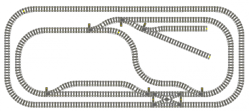

Exa Posted July 5, 2014 Posted July 5, 2014 (edited) Hello, I am just starting with Lego trains but I am familiar with the trains. I already got HO and Merklin N trains. Here is what I got : Tracks only : 6 x 7499 Flexible and Straight Tracks 1 x 7895 Switching Tracks 1 x 7996 Train Rail Crossing Box : 1 x 60051 High-Speed Passenger Train 1 x 66374 City Super Pack 4 in 1 (damn, I just see I got 66405 not 66374) So : 6 x 8 + 4 + 20 = 72 straight 16 + 20 + 4 = 40 curves 1 crossing 6 switchings I got some goals for my track : - 2 trains can run at the same times - it can reverse a train - it can park unused wagons - One part is for *speed train* so with as few crossing as possible - A station stop track (where a train can stop allowing other to run) - Not a too large nor long layout (due to WAF) 3 meters long and as narrow as possible Due to Super Pack 66405, I will have use flex track (dont like them much) because 4 curves are missing. I will place the flex track in the reversing loop area. Any advice about my track layout is welcome !!! Current size is 2.88 m x 1.22 mm. Ps : Sorry for my poor English. Edited July 5, 2014 by Exa Quote
garethjellis Posted July 5, 2014 Posted July 5, 2014 Hey Exa. Sadly you can not run two trains at once using the double crossover Lego made. The switching mechanism it connected to both sides so when the left lower is switched strainght the left upper is switched cross track. Quote
Spitfire2865 Posted July 5, 2014 Posted July 5, 2014 I can tell you with the double crossover you will not be able to run two trains at once. Quote
yeomanry_trooper Posted July 5, 2014 Posted July 5, 2014 If you don't mind modifying two pairs of points you can have a layout that will allow you to run two engines at once.. There are some really useful ideas about doing this on this previous topic http://www.eurobricks.com/forum/index.php?showtopic=90187 Quote
JopieK Posted July 5, 2014 Posted July 5, 2014 you can with the double crossover, but not without modifying it, I modified mine and now I can :) Quote
Exa Posted July 5, 2014 Author Posted July 5, 2014 (edited) Thank you. So sad ! :( I se this on a french website. Is it wrong ? If inner train (yellow) run clockwise and outer train (green) counterclockwise, will it work ? I was planning to use this setup for two trains (even if they have to run in only one way) The second setup looks fine for single train. Is there a file dedicated to track sample ? EDIT : Thanks for all replies (when I was answering). Edited July 5, 2014 by Exa Quote
kieran Posted July 5, 2014 Posted July 5, 2014 If you don't mind modifying two pairs of points you can have a layout that will allow you to run two engines at once.. There are some really useful ideas about doing this on this previous topic http://www.eurobricks.com/forum/index.php?showtopic=90187 If you modify switches you do get the best of both worlds, I have mine working well now if you need any tips Quote
ScotNick Posted July 5, 2014 Posted July 5, 2014 If the trains run in the opposite direction it will be possible to run both at the same time with the double crossover. Are you gonna build something around the layout, or only the tracks? It's looking great so far! Quote
Exa Posted July 5, 2014 Author Posted July 5, 2014 Thank you all for your advice. For now, I prefer not to cut out brand new Lego parts. If both train can run the opposite direction, it's good enough for me. I will try my first design for some days. I still have to receive the crossing (I hope during the week). I have reworked my layout to have an alternative solution. This way, I lost parking area but the two rings can avoid the crossing. Layout v2 I will complete the loop junction with flex track. Buy the way, I'am keep on trying with a third révision (with two more switching). Layout v3 I like v3 because lower part looks like a *true* complex station rail road. Quote
jodawill Posted July 5, 2014 Posted July 5, 2014 If I were you, I'd sell the crossover because it's very valuable. I would them use that money to buy another train. :) Quote
LEGO Train 12 Volts Posted July 5, 2014 Posted July 5, 2014 If I were you, I'd sell the crossover because it's very valuable. I would them use that money to buy another train. :) This is an original point of view! Quote
Exa Posted July 5, 2014 Author Posted July 5, 2014 (edited) If the trains run in the opposite direction it will be possible to run both at the same time with the double crossover. Are you gonna build something around the layout, or only the tracks? It's looking great so far! Thanks. Well, I will first put track on the floor. Than I plan to add some rail road buildings. Currently, I have no more advanced project. If I were you, I'd sell the crossover because it's very valuable. I would them use that money to buy another train. :) That's a point of view but I really like the crossover. It gives some realistic look to a track. I found a second hand one for 75 €. Happily, I don't need those euros back to buy a new train. Three trains are enough for now. I just need one more 7895 witching tracks set to get all what I want ! - Outer track is fine for fast trains (most straight). - Two trains can run in any direction by not using the crossover. - One train can do a lap all over the track using the crossover. - Two trains can wait at station and up to two train still can run. - Reversing loop. - Keep 2.88 m x 1.22 m small footprint. Layout 4 44 curves 72 straights 4 left switchings 4 right switchings 1 crossing I plan to build the track next week end. Edited July 7, 2014 by Exa Quote

kieran Posted July 6, 2014 Posted July 6, 2014 Looks good, will you have easy access to operate the switches at the back. Quote
cimddwc Posted July 6, 2014 Posted July 6, 2014 Keep in mind that some trains have quite a long overhang in the front/back when going around curves and switches. That is, you won't be able to put much of a platform in between the tracks at the station, only on the two outer tracks. The innermost track should be a bit longer anyway - it looks like you could move the switch on the left one track piece further to the left. Quote
ronenson Posted July 6, 2014 Posted July 6, 2014 (edited) I suggest to move your double cross-over to the right by two pieces, and move the switch thats in the way up. This way you get more straight track that can be used for platforms. Nice layout by the way Edited July 6, 2014 by ronenson Quote
zephyr1934 Posted July 7, 2014 Posted July 7, 2014 With only one or two extra parts you can also disable one branch of the double crossover and run two trains in the same direction through it without conflict (see RailBricks 9 for details). I like version 3 of your layout, you are packing a lot in a small space. Though don't worry too much about it, I am sure you will quickly find that you want more and more and more track. Quote
Exa Posted July 7, 2014 Author Posted July 7, 2014 True I forget about overhang and platform ! Thank you to point it out. I'am going to work again and again. @ zephyr1934 : I will read this book. Quote
Exa Posted July 7, 2014 Author Posted July 7, 2014 (edited) Here is the first updates I made to take care about platform and overhang. Big dark rectangle is clearance for 60050 station (a future set). Smaller area are for 7937 platforms. Layout 5 Advantage : 3 decent platforms, can have a big station, funny inner track Down side : shortest inner track, wasted space in down left corner Layout 6 Advantage : 3 long platforms, can have a big station, longer inner Down side : looks a bit simple and *symmetric*, use flex track I read the RailBricks 9 and I know fully understand how crossing can be used a more clever and space saver way. Layout 7 Advantage : decent platform, funny inner track, nice area for city and creator buildings, longest inner track Down side : only 3 tracks wide station Now, I just have to make up my mind and choose one layout. Currently, last one is my favorite. Edited July 8, 2014 by Exa Quote
