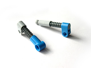

@piterx: I'd like to try replace the gray shock absorbers with the springs you used in your Ford Fiesta WRC but couldn't find them, could you please point me to their BL catalog entry? (or add the link in your blog post)
Yeah, I imagined the spring is the same as in the gray shock absorbers, I was just hoping I could find the springs by themselves in BL so that I wouldn't have to take shock absorbers apart -- ah well, I just did :D
