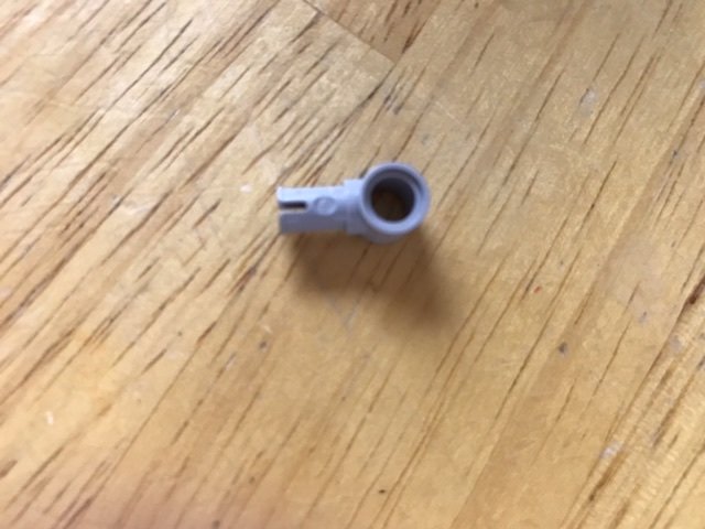

40 minutes ago, hawkwind said:
Is there a frictionless variant of this piece?
nope, the closest you can do is part 48989 connector block with 4 pins.
