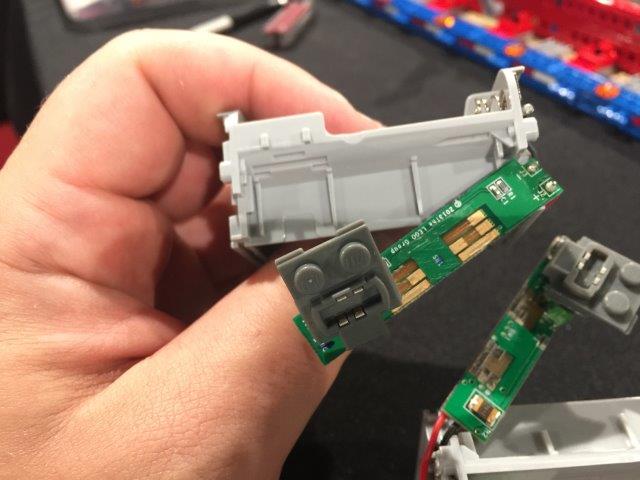

So, recently I got new rechargeable batteries - Ni-Zn 1'6V 2500mWh ones . Unfortunately , I was disgusted finding out that my 8881 battery box won't work with them. Quickly discovering that those batteries do work in an old rc train base (part 55455c01 ) I tested the 8881 with alkaline 1'5V batteries - it did work.
My question is , do I have to overcome ( solder a wire over it) this element in the circuit board ( marked with the arrow ) to be able to use these 1'6 batteries ?
Image courtesy of Philohome
The part the arrow points to is called a resettable fuse.  It seems to appear in slightly older versions of the battery box.  These typically have a dull, yellowish green power indicator LED, while the newer boxes have bright, darker green LEDs.  Unfortunately that seems to be the only way to tell them apart from the outside-- they have the exact same part number and look identical from the outside.  The job of the resettable fuse is to keep power (current) output from going above a set level.  What this means is that, if you are driving a heavy load *OR* (in your case, likely) if you are using batteries that have a lower voltage or lower current capacity than standard Alkalines, the fuse gets tripped earlier and more often than it should.  The most common indication of this will be lights flashing many times per second, or motors not operating near capacity.  My guess is that LEGO realized the circuit board with the fuse was a design mistake, which is why the fuse is absent from the newer versions of the box.  It simply is not needed, and it does much more harm than good by interrupting power flow when it shouldn't.  I don't know what can be done about the version of the circuit with the fuse on it-- I've not tried bridging it or removing it.  There are other components on this version of the circuit board that are also missing from the newer version, so I can't say what impact bridging the fuse wold have on the overall operation.  Best bet is to find a newer box.  How to do that?  I just buy them 10 at a time from LEGO and check the color of the LEDs. :-)
Here is a photo (not the best quality) of the newer version of the circuit board-- you can see the fuse is missing.  In the background of the photo is the old version, with the fuse.
ahh so thats the difference between the light and dark lights on the battery boxes... i have 4 of the old one and 3 of the new one and i was woundering what the difference is, thanks for sharing! :sweet:
@Rob Klingberg  Thanks for the detailed explanation, I was fortunate enough to have a broken Battery Box and asked to the Customer Service for a replacement.  Both of my battery boxes (or what is left of them) are the old version (yes, I dismantled them and even modded one to fit a 9v battery) so hopefully I will be provided with a newer version. The problem was that the higher voltage batteries (1'6 instead of 1'5) weren't working with that battery box design, even without load. And having in mind my abilities to solder (50% is a fail) it was better to ask before doing something dumb.
Thanks for the explanation of the batterybox circuit, it clarified a lot of things to me!

49 minutes ago, LXF said:
Effectively, I received a new style battery box (the LED is of a different green and there are some small aesthetic changes in the box itself. And the most important - it does work!
https://flic.kr/p/RtWEHf
Glad it works!
2 minutes ago, Zero (Zblj) said:
So new battery boxes have no current limiters? Which means you can use them with PF2.0 receivers and RC motors?
Correct, the new-style battery boxes have no current limiters.  Not sure if this means they will work with the parts you mentioned (I've tested with the PF 2.0 receiver but not an RC motor), but technically yes they should be able to put out as much current as the installed batteries will allow.
