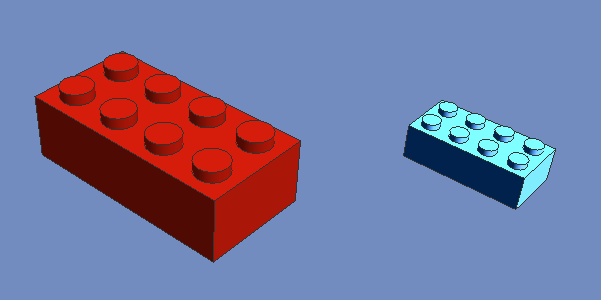

I was wondering if there is any way to scale parts in LDCad. I've read in the FAQ that "Models using 'mirroring' or 'scaling' will not render correctly" but I can't find the option to scale part anywhere. I would like to scale down the Classic Space sticker in the following model:
Thanks for the help.
Hi MReizinho,
Mirroring does render odd indeed, but scaling can be done.
I don't know how to do this _in_ LDCad, but I know you can adjust the matrix in the LDraw file. It is just text, so you can edit it.
For example with the 3001 brick 2x4 edit the 1 0 0 0 1 0 0 0 1 part in the matrix:
1 4 0 0 0 1 0 0 0 1 0 0 0 1 3001.dat
to for example half size (1 > 0.5)
1 1 80 0 60 0.5 0 0 0 0.5 0 0 0 0.5 3001.dat
Edited by Jaco
You can edit those numbers in LDcad by clicking the little info-box with XYZ info that appears when you select a part. :classic:
Ah, so true.
There is no direct method, interface wise, to scale say 50% so that LDCad makes the change to the code.
You will have to do it manually, but in LDcad like legolijntje described.
Thank you both, that did the trick! And Roland is right: parts using scaling will not render correctly. But only if you enable "Lighting" in LDraw Preferences menu.
Technical reason:
Each part in LDCad has been flattened geometry wise in order to allow for fast rendering, scaling/mirroring will (also) affect the containing normals and thus mess with the lighting.
Workaround:
Put the slope part with its scaled sticker in a new .dat containing a "0 UNOFFICIAL PART" line. This will make it a new part which will be flattened separately and thus render correctly.
Edited by roland
