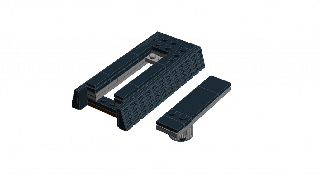

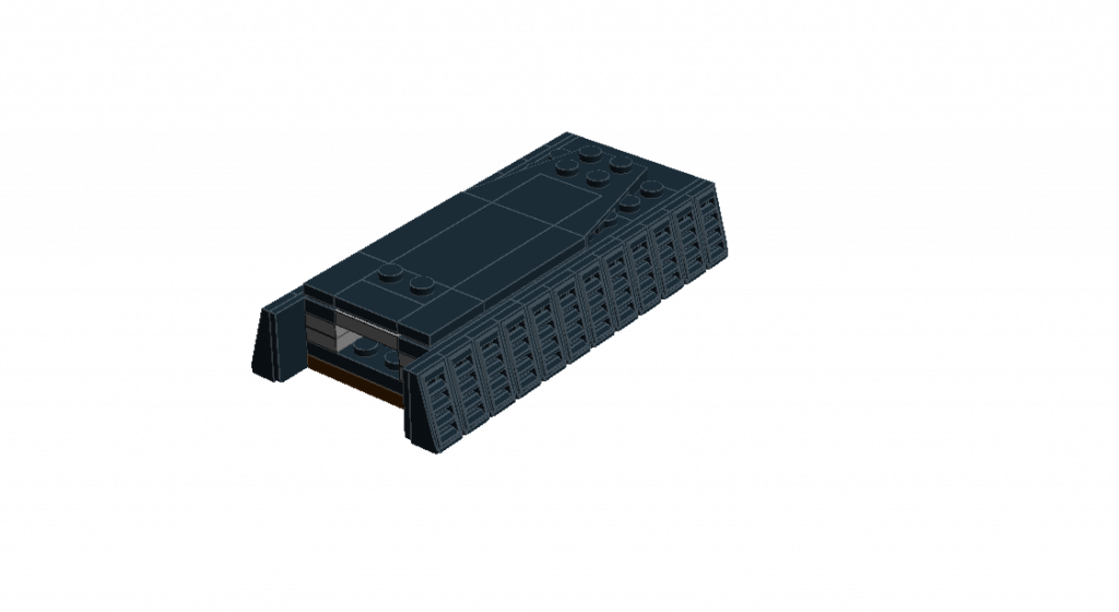

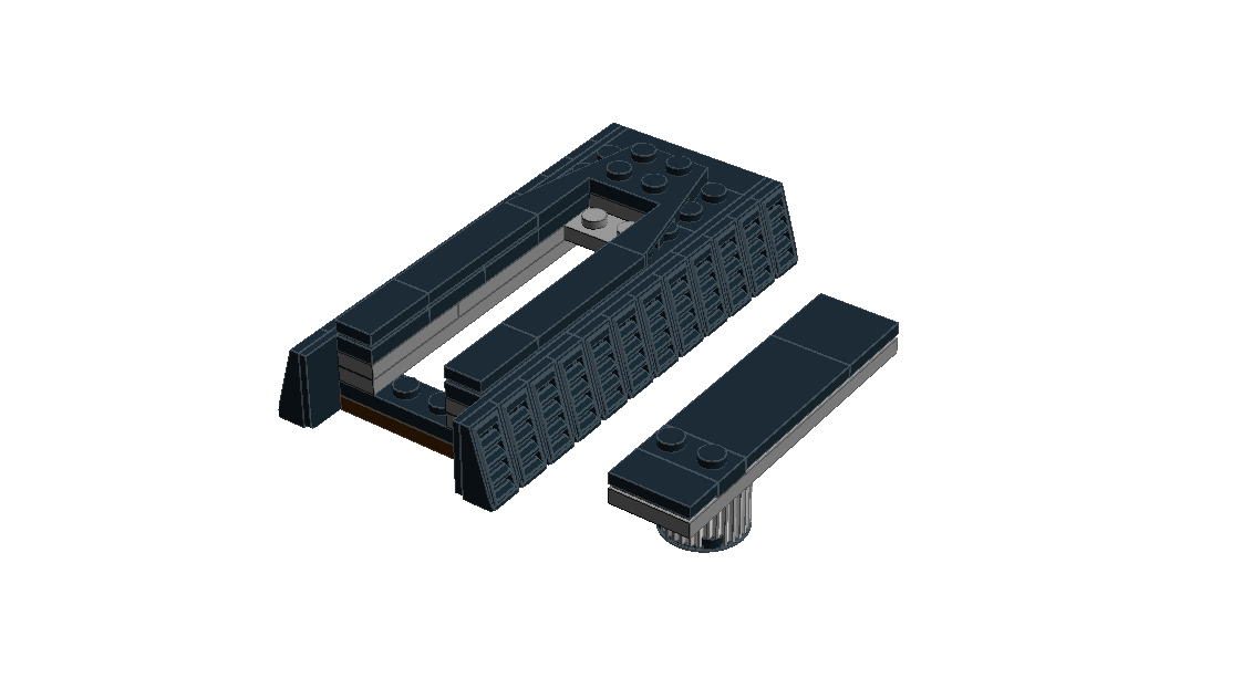

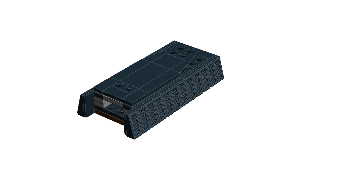

ronenson Posted December 6, 2014 Posted December 6, 2014 (edited) We regularly run a couple of quick laps with the Horizon Express when bringing my son to bed. Downside is that I have to take off the "lid", switch it on and put the lid back on. Then the same procedure to switch it off. I decided to make a quick mod of the roof part that covers the battery inspired by how the 7939 switches on and off. Taken slightly apart: I show it here as LDD screenshot because the pictures wouldn't make it clear. It works like a charm. Simply push the studs, and the battery switches on or off. You almost don't notice the difference with the original, but it's so much easier. Edited March 15, 2018 by ronenson Corrected images Quote

rockethead26 Posted December 7, 2014 Posted December 7, 2014 ronenson, Being new to trains and just setting up my first PF system, I cannot quite tell what you've done. I understand what you accomplished, but don't understand how. How does pressing on the 1 x 2 studded plate transfer a push to the switch? Thanks, Jim Quote
dr_spock Posted December 8, 2014 Posted December 8, 2014 Pressing on the location of the 1x2 plate causes the 2x8 plate to bend slightly. That in turn causes the round brick and bottom round tile to move downward. The bottom round curved tile is the piece that actually presses against the green button on the battery box. Quote

rockethead26 Posted December 8, 2014 Posted December 8, 2014 Pressing on the location of the 1x2 plate causes the 2x8 plate to bend slightly. That in turn causes the round brick and bottom round tile to move downward. The bottom round curved tile is the piece that actually presses against the green button on the battery box. Thanks, Dr_Spock. I think I've got it. Quote
