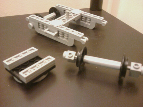

February 4, 201510 yr https://www.shapeway...ange-lego-wheel Small flanged wheel. NB: will very likely derail through switches and maybe even standard lego curves if your wheelbase is long. Dimensions should be correct, but let me verify them tomorrow when I regain access to a real wheel to compare to. Maximum width of flange is 23.95mm, which is just under the 24mm 3 stud width, so it shouldn't rub against adjacent bricks (unlike the official Lego wheels....) and fit nicely. I'm interested in these wheels. How much smaller is the flange compared to standard technic axle train wheels? I'm wondering if I could put a pair of these between two pair of normal train wheels to make a 3-axle truck and not have any issues with wheels rubbing against eachother.
February 4, 201510 yr Author I'm interested in these wheels. How much smaller is the flange compared to standard technic axle train wheels? I'm wondering if I could put a pair of these between two pair of normal train wheels to make a 3-axle truck and not have any issues with wheels rubbing against eachother. I'm afraid these are not what you are looking for. The flange is smaller but the overall size is the same. I could however whip up a blind wheel for you. God knows it'd be useful in my own designs as well. Sliding middle axles are tricky when the bogie is PF powered.
