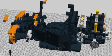

I'm half way creating the X-Bow in Stud.io with the goal to freely distribute the building instruction.
Took me already 2 days to put all parts in the right order and in 70 steps that resemble building steps, probably the instruction will be around 300 steps when finished.
I'm also building the model the same time so see if everything is in the right order to be able to build.
Edited by Berthil
Digitization of the design of Jurrs continues. Added front and rear license plate holders (will have X-Bow stickers), 3rd breaking light, rear diffusors, redesigned exhaust with elbow at the left and improved engine mount with integrated HOG steering guidance. The engine was hanging on two pins in the .lxf and I cannot see on Jurrs photos if he did something there to have more supportive engine mounts. The modifications are add-ons and can easily be left out as original structure has not been changed.
I've used blue pins and red axles to improve the building instructions (same purpose as LEGO has introduced the 3L blue pins) but final build model will have black pins and axles.
Now waiting for some parts to continue so everything is tested.
I think, there were not more, because there where not much options, if I remember correctly. Maybe, after long building, I was happy with that I had.

Full digitization done for the building instruction which has 183 steps and 658 parts in total. Also added radiators and filled up the rear with more diffusors.
As said red axles and blue pins will be replaced by black in the build model.
Orange big wings are a situated too high at the back but build model looks the same as from Jurss when build.
Building instruction and pictures of the build model to follow soon.
Rendering done in stud.io, no idea why it is floating.
Edited by Berthil
