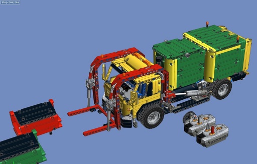

Hi,
It's a bit of an old topic, however...this summer someone noticed that I build this model using the pictures and video posted bij Waler. And asked me if I could help recreating this very nice MOC.
i took the challenge and rebuild the MOC again, this time using the build to improve my LDCad skills. Here's the result. Now I'm fighting LPUB to create instructions :-).
