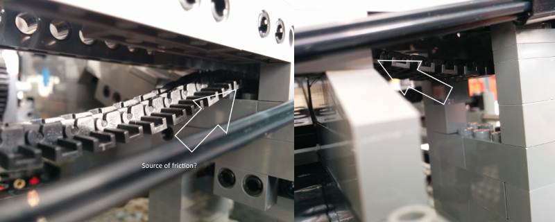

wimpie3 Posted June 5, 2015 Posted June 5, 2015 Is it normal that the two chains (transporting the basket) are hanging very loose on the underside? I have counted the exact amount of links as instructed, but the chains do not fit tightly around the gears. Quote

wimpie3 Posted June 11, 2015 Posted June 11, 2015 Guys, I need some help here. I'm having an issue with the second bucket chain. Please take a look at the attached image. I have the impression the chain is hanging really low on the underside. I've measured the chain multiple times, it has the correct length. When I run the machine, the chain often skips on the gear, causing a stuttering motion. Sometimes the chain also gets stuck at the on the support pillar (see the arrows on the image). I really haven't got a clue on what can be wrong here... Quote

Blakbird Posted June 12, 2015 Author Posted June 12, 2015 I'm having an issue with the second bucket chain. Please take a look at the attached image. I have the impression the chain is hanging really low on the underside. I've measured the chain multiple times, it has the correct length. When I run the machine, the chain often skips on the gear, causing a stuttering motion. Sometimes the chain also gets stuck at the on the support pillar (see the arrows on the image). I really haven't got a clue on what can be wrong here... I can't spot anything obviously wrong from your pictures, but I can say that I've had zero problems with the conveyors. Must be friction somewhere. That sentence pretty much sums up any problems you will encounter with the ball factory. Finding the friction can be quite a challenge. Use process of elimination. Quote
