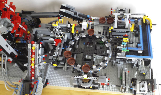

Jonas Posted May 5, 2016 Posted May 5, 2016 (edited) As I promised earlier, I am sending a couple of pictures to show how I made the spiral tower construction more stable. For me, the weakest point was the platform made of two horizontally laid arches. The platform hovered in the air as the small gap (indicated by the black ellipse) did not allow to place a standard plate there. I used a SNOT technique to get a stronger platform. It allowed me to remove the gap and to fix the superstructure to the studs. Moreover, I used the remaining stud of the 30414 brick to stabilize the tower column by a vertical 1x6 tile. Now, each column is fixed from 3 sides and the tower is really stable. It will survive even an accidental kick. And, I added another (third) black pin to strengthen the vertical support (shown on page 186 in Blakbird's manual) Edited May 5, 2016 by Jonas Quote
Jonas Posted May 6, 2016 Posted May 6, 2016 (edited) I have also made a small improvement of the ball picker - the part that picks a pair of balls and puts them into a bucket. It happened quite often that the right ball dropped before it reached the bucket. When I analyzed the construction of the picker, I noticed that the rightmost axle is significantly looser than the other ones. While the other two rear axles are attached to the rail construction, this one is not and cannot be attached. In my version, I fastened this axle to the rest of the assembly by replacing a 3L liftarm by an L-shape liftarm (not necessarily in yellow color). -> Since that time I have not observed any earlier drop. Edited May 6, 2016 by Jonas Quote
bj51 Posted May 6, 2016 Posted May 6, 2016 Interesting, I tried those exact changes on the ball picker as well. In the end the L-shaped liftarm didn't change anything for me though, but the 5L liftarm with axle holes did fasten the balls a little better. Quote

Jonas Posted May 12, 2016 Posted May 12, 2016 (edited) Another critical point - at least in my realization - was the the bucket shift mechanism, and namely the rectangular lever. Sometimes, the parts making the lever disconnected and the shift mechanism stopped working. It always was a painful job for my fingers to repair it. I have made the lever stronger as shown in the picture. -> It does not look that elegant as the original but it works and it is hidden in the remote corner of the layout. Edited May 13, 2016 by Jonas Quote
wumsi Posted May 14, 2016 Posted May 14, 2016 (edited) Another critical point - at least in my realization - was the the bucket shift mechanism, and namely the rectangular lever. Sometimes, the parts making the lever disconnected and the shift mechanism stopped working. It always was a painful job for my fingers to repair it. I have made the lever stronger as shown in the picture. It does not look that elegant as the original but it works and it is hidden in the remote corner of the layout. By any chance, did you build your factory after blakbirds instructions, and did you put those two tiles there? If that is the case, you might want to try removing the inner tile. The bucket shifter seems to run into them, and break the link you improved. Edited May 14, 2016 by wumsi Quote
Jonas Posted May 15, 2016 Posted May 15, 2016 (edited) By any chance, did you build your factory after blakbirds instructions, and did you put those two tiles there? If that is the case, you might want to try removing the inner tile. The bucket shifter seems to run into them, and break the link you improved. I remember this problem from the building phase. Anyway I checked it and it is OK. I used only the outer tile. Usually, the lever disconnected when buckets got jammed. The problem was that the original lever could get disconnected in four places. Now, when jam occurs, the lever can still be disconnected (and it is good for global protection of the whole mechanism), but it will happen only in one place - the rightmost one - which is well accessible by fingers. Edited May 15, 2016 by Jonas Quote
