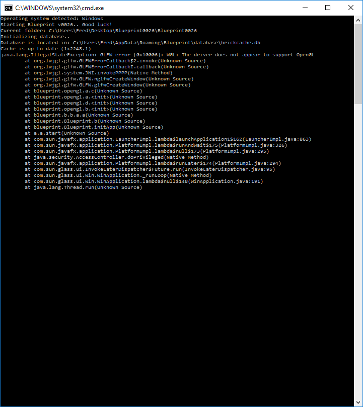

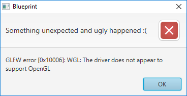

Fiver Posted September 8, 2017 Posted September 8, 2017 Still experience the same issue. Windows 10, Blueprint 0026 and my graphics card is Intel Core i3-2130. I've attached a screenshot of the command line and of the error I get. It's strange to me that Bluerender is working and Blueprint is not... Any help very much appreciated. Thanks. - John Quote
kokkie20 Posted September 8, 2017 Posted September 8, 2017 3 hours ago, Fiver said: Still experience the same issue. Windows 10, Blueprint 0026 and my graphics card is Intel Core i3-2130. I've attached a screenshot of the command line and of the error I get. It's strange to me that Bluerender is working and Blueprint is not... Any help very much appreciated. Thanks. - John I did some searching on internet and not sure if this will fix it, make sure you backup your drivers or get at least the installer for it ready when it go's wrong. There seemed to be a problem with intel drivers on windows 10 combined with glfw Patcher <<< Found a "patcher" that may be a solution for this problem, tough not sure if it will work, but like i said above Make sure you backup your drivers or have a installer ready for when it doesn't work correct For the rest i have no clue how to fix this except you can try the patcher Quote
