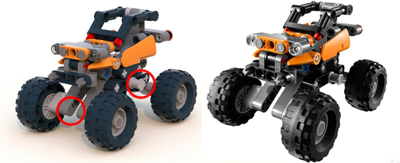

__________________________ Posted July 4, 2015 Posted July 4, 2015 See post #162 (pg 7), and post #203 (pg 9) of this forum. Also https://flic.kr/p/tK2MXw Notable differences: Bluerender does not offer bevels (joints between bricks) or the LEGO logo on the studs, both of which are available on higher settings on POV-Ray. But Bluerender is MUCH faster and looks more natural (in my opinion). For example, in that Flickr image link I supplied, the white tables look gray in POV-Ray and the overall look is sort of hyper-real. Bluerender seems to look more like a well-lit photograph to me. Yeah, I prefer the way POVRay looks, but this is still very impressive technology, especially for slower computers- I've heard of POVRay renders taking days for sub-1000 piece models Quote
