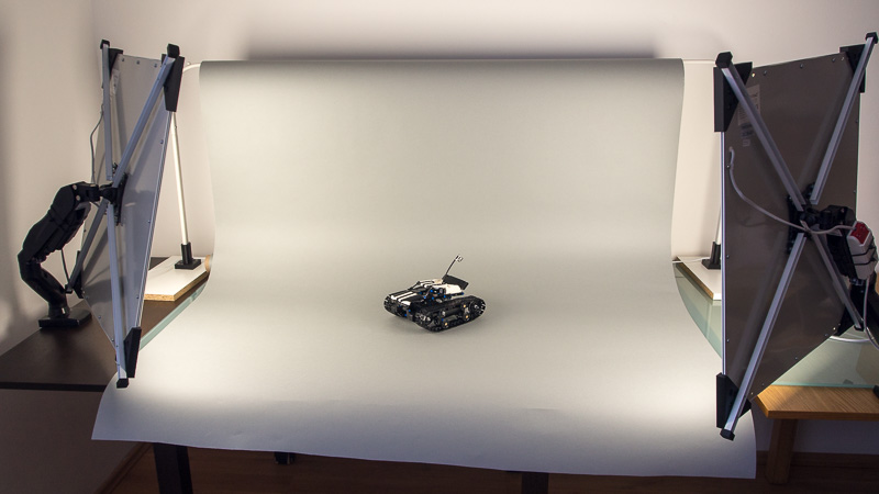

Let me share a pic of my DIY home studio setup. You don't need that many things or really expensive stuff to achieve some good results. The only "professional" element is the grey (and white) paper roll for the background. The rest includes a modified IKEA clothes rack, some other leftover IKEA furniture pieces, two 45W LED panels, two monitor arms, and some 3d printed pieces to hold these together :)
Looks like a nice setup! But obviously, I am very interested in a picture taken with this setup :wink:
Thanks Jim! Not much to share (yet :wink:), but most of the pictures on my blog are/will be created with this setup. I'm working on a longer post & video about 42065 Tracked racer mods, will post it soon!
