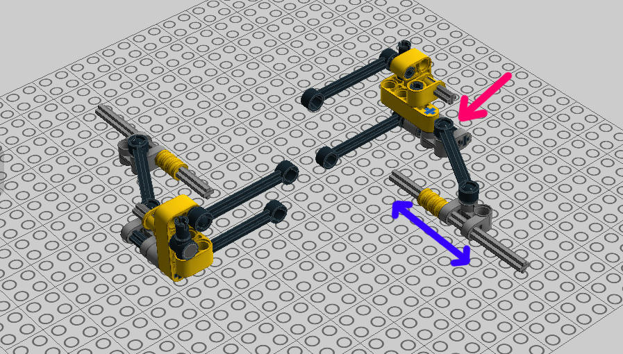

Victor Imaginator Posted August 20, 2015 Posted August 20, 2015 Thanks. It wasn't clear at upper post, now i see) You can try to add diagonal links to negate toe-out. Quote
falconluan Posted August 20, 2015 Author Posted August 20, 2015 Thanks. It wasn't clear at upper post, now i see) You can try to add diagonal links to negate toe-out. Can you please use some pics as reference? I don't know much about the suspension things but really interested in your suggestion. I think the connector of the trailing arm of real thing has 3 dimensions freedom unlike mine model which only have 2 dimensions, on the other hand, the connectors of the 2 linkages on the real thing have more limitation in movement compared to mine model which uses ball joints. Quote
Victor Imaginator Posted August 20, 2015 Posted August 20, 2015 (edited) Not a solution, just an idea. Ball joint at pink arrow must be fixed to prevent sliding off the axle, grey 9L axle should be fixed to frame. Sliding U-shaped connector along the axle will adjust toe-in/out. Edited August 20, 2015 by Victor Imaginator Quote
falconluan Posted August 20, 2015 Author Posted August 20, 2015 Not a solution, just an idea. Ball joint at pink arrow must be fixed to prevent sliding off the axle, grey 9L axle should be fixed to frame. Sliding U-shaped connector along the axle will adjust toe-in/out. Thanks a lot! I'll try this setup out. Using the steering link as trailing arm may introduces left/right swing movement of the wheel hub, maybe it is limited by the 2 links, anyway, I'll try this Quote
