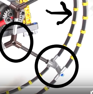

February 16, 20205 yr On 9/9/2015 at 10:18 AM, oracid said: My goal here is to provide a big vehicle for some robotic application. - length 75cm - width 47cm - height 28cm - wheels 27cm - weight 1,750kg  Hi we spoke on youtube please see attached image  the 2 parts in circles and the 1 with the arror pointing to it . what are the bits called . and what is the total diameter of the wheel it self best regards james Â
February 17, 20205 yr Author Hi. Here some pictures and links those I hope they will help you. The wheel diameter is 27cm. Each yellow bush are separated with soft silicon tube. https://www.bricklink.com/v2/catalog/catalogitem.page?P=32034&idColor=86#T=C&C=86 https://www.bricklink.com/v2/catalog/catalogitem.page?P=10288&idColor=120#T=C&C=120 https://www.bricklink.com/v2/catalog/catalogitem.page?P=6538c#T=C https://www.bricklink.com/v2/catalog/catalogitem.page?P=4265c#T=C https://www.bricklink.com/v2/catalog/catalogitem.page?P=43093#T=C Â Edited February 17, 20205 yr by oracid
