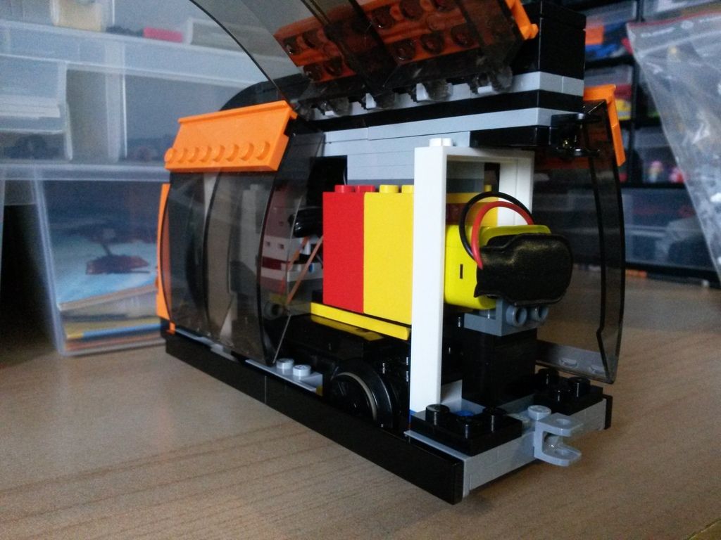

So I went to bricklink the project tram, and I only spent EUR25 for the important parts of the tram, like the windows, orange parts, connectors and other essentials. I wanted to motorize it via power function. Putting the motor, battery and receiver in one carriage will be difficult since the curve of the windows will not permit it.
So I hacked a Lego extension cord and came up with this (copied what others did in using the 9v battery). I used a 9V battery to make it compact and light.
So now I managed to fit everything inside the front carriage
The completed model

Its easy to modify the 8404 blue tram. It's shape is almost rectangular so you wont have problems fitting the battery box including the receiver and motor. I tried it on the 60097 and it wont fit all in one carriage due to sloping shape from the roof to the bottom. The battery box will sit on top of the motor and it will hit the windows. The 3 carriage all 12-stud 8404 was powered by 9V so its very easy mod. The Power functions 8404 was more heavily modded since it meant building two more additional carriage, one a 16 stud carriage to carry all the electronics and an 8-stud one to help with the bends.
My original plan was to make the middle carriage (16 studs long) carry all the electronics. But when I tried to run it, it always derail since it cannot bend on curves. Three 16-stud carriage will not work. I tried to put in train buffer beam and it works great but the distance between carriage was too far.
So I went back and transferred all the electronics to the first carriage and revert to a 4-stud middle carriage.
Maybe my original plan of 16 studs middle carriage will be good if I will also put in between it a small 4-stud carriage like in the original to help in the curves.
