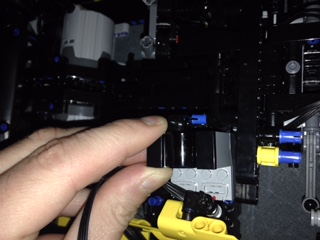

Hohag Posted February 17, 2016 Posted February 17, 2016 (edited) Hi, i rebuilt your car. Buti cant fix the Receiver for the Stearingwheels. It s not enaugh Space. The Receiver Is to high. Did You change anything? I Need help Greets Holger Edited February 17, 2016 by Hohag Quote
filuS Posted February 18, 2016 Posted February 18, 2016 When I was building this model I needed to make few modifications because some things simply weren't fitting or looked a bit misplaced (it was quite tricky for that front receiver, it doesn't seem to fit in there at all - I ended up with creating some so sort locking mechanism for it, so even if it just sits there it doesn't move freely). The biggest problem I still have is that when fully steered, front wheels are touching the plate headlights are sitting on, effectively disconnecting it while moving. I am not sure why is that so - I am positive that everything is done according to instructions and the look of my car matches the original look from pictures in here. But I didn't really build it to play with it, so I can live with this little flaw, even though it bothers me a bit. Quote
brunojj1 Posted February 18, 2016 Author Posted February 18, 2016 (edited) Hi, i rebuilt your car. Buti cant fix the Receiver for the Stearingwheels. It s not enaugh Space. The Receiver Is to high. Did You change anything? I Need help Greets Holger Dear Holger, first of all thanks for building my model! I´m aware about the problem with the 3. receiver and got similar feedback from others, Sorry for that! I admit the whole section on the "passenger´s side" is a bit messy and kind of poor design, some improvements can be done here for sure. I remember last time I had built the model I changed the position of the receiver and turned it facing forward. At the moment I have mine disassembled, sorry if I can´t really help you. I hope you´ll fiind a solution and enjoy the model anyway, the more after the hard work ! When I was building this model I needed to make few modifications because some things simply weren't fitting or looked a bit misplaced (it was quite tricky for that front receiver, it doesn't seem to fit in there at all - I ended up with creating some so sort locking mechanism for it, so even if it just sits there it doesn't move freely). The biggest problem I still have is that when fully steered, front wheels are touching the plate headlights are sitting on, effectively disconnecting it while moving. I am not sure why is that so - I am positive that everything is done according to instructions and the look of my car matches the original look from pictures in here. But I didn't really build it to play with it, so I can live with this little flaw, even though it bothers me a bit. I know you were one of the first who built it ! Such issues bother me too and guys like you encouraged me to make improvements in the building instructions, and there were made some already. But I can´t get why the wheels pull off the headlights while steeering, maybe you have to move them (headlights) 1 stud outward. If there still are such issues I´ll figure them out when rebuilding it next time and fix the BI. Thank you too for your feedback! Edited February 18, 2016 by brunojj1 Quote

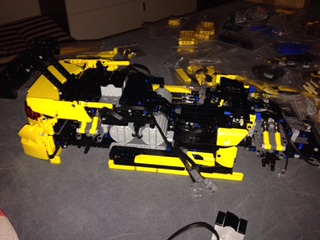

SH3V1974 Posted February 18, 2016 Posted February 18, 2016 Hi all, Around p140 of this AWESOME build. @Hohag I also had problems with the 3rd receiver to get in place. But managed to do it. Had to look at it and tried different things. At picture 79, p123, part 3023 is used 2x but in my build i left it out. I have on the receiver 2x 3024, then the end of the servo motor and 3004 on the battery box and this with on top 1x2431. Dunno if this makes any sense. @brunojj1 picture 88, p137, the 6 black pieces. What are they. Did you use 6x4697b and cut of a piece of the t-piece? As for the steering of the 2 front wheels, looks like the 32278 will be in the way for turning. Not there yet, so cant tell for sure. Here is a little video of the work so far. Quote
brunojj1 Posted February 18, 2016 Author Posted February 18, 2016 Hi all, Around p140 of this AWESOME build. .... Dunno if this makes any sense. @brunojj1 picture 88, p137, the 6 black pieces. What are they. Did you use 6x4697b and cut of a piece of the t-piece? As for the steering of the 2 front wheels, looks like the 32278 will be in the way for turning. Not there yet, so cant tell for sure. Here is a little video of the work so far. I hope it makes sense although I couldn´t understand everything, but if you managed to get it fit, it´s pretty fine . The black pieces in the BI are made of a rigid hose cut into 2L lenghts. I also have used the 4697b T-pieces instead everywhere. The first solution would be cheaper and look better. The steering wheels shouldn´t collide anywhere, except the panel above the front wheels when the suspension is pressed down. Quote
SH3V1974 Posted February 18, 2016 Posted February 18, 2016 I also did it like that using a black rigid hose from incomplete builds i bought. Cut them into pieces of 1cm As for the steering wheels i hope not. And again thank you for M. Martin car. Quote
filuS Posted February 18, 2016 Posted February 18, 2016 This is how I solved that IR receiver in front - it is not locked in place with pins but rather a liftarm. Maybe it is not the most beautiful solution but if it works it works :) As for wheel-headlights touching during steering problem, I don't really have a solution for that. Headlights are where they are supposed to be, half a stud to the middle/front and they would look kind of misplaced. Aesthetically they look like they are where they are supposed to be, unfortunately it just does not work mechanically. Maybe I really did something wrong and others don't have this problem, that's a possibility too :) Quote

Hohag Posted February 19, 2016 Posted February 19, 2016 (edited) Helle, Thanks for our help. I saw the pictures and i try to fix ob the Same way. It's a very nice car. After the yellow i want to Build the Black one for the Lego gerage. Holger Edited February 19, 2016 by Hohag Quote
