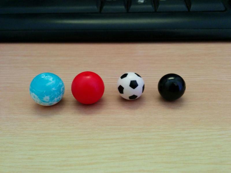

ThiagoMaster Posted May 28, 2016 Posted May 28, 2016 (edited) Sooooo... Talking about balls: how many of you have tried non-lego ones? I recently bought some 14mm beads to test, but they are a bit smaller and lighter. I believe i won't have trouble in models that do not move balls individually, but I do think it will hugely impact models that move balls individually, like Fork to Fork and planets. What have you guys experienced so far? The generic one is, obviously, the black one: Edited May 28, 2016 by ThiagoMaster Quote

nychase Posted May 29, 2016 Posted May 29, 2016 Sooooo... Talking about balls: how many of you have tried non-lego ones? I recently bought some 14mm beads to test, but they are a bit smaller and lighter. I believe i won't have trouble in models that do not move balls individually, but I do think it will hugely impact models that move balls individually, like Fork to Fork and planets. What have you guys experienced so far? The generic one is, obviously, the black one: https://www.amazon.it/Quercetti-2530-Marbles-Refill-Ricambio/dp/B00TWFXCEA/276-0142546-4456352?ie=UTF8&*Version*=1&*entries*=0 Earlier in this thread (May 4th to be exact) someone posted the link I just reposted above. I took the plunge and ordered 10 (yes TEN) packages of 100 balls each. Total cost was 82 dollars shipped which I thought was beyond fair since that would net you less than 40 balls (vs the 1000) at todays bricklink prices for soccer or basketballs. I received them a week ago and everything was as promised. Even better than stock lego was that the balls don't have the molding holes that can cause them to get stuck on low incline locations. Now I haven't fully tested these for 100% compatibility but when the link was posted the poster mentioned that he has them working perfectly in Bucket Factory and that has seemed to be the most picky GBC out of the 23 so far. Since Blakbird has all the models built I can send him a bunch of the balls to test (if hes willing) since we seem to have now found a reliable (amazon) and cheap source with international shipping for near perfect replacement balls that will finally end the reign of terror that Bricklink/LEGO has had on us for GBC balls. Quote
Dufeyz Posted May 29, 2016 Posted May 29, 2016 Well, if those balls are compatible. Definitely let us know. :) I have been lurking here for a few days now, and i made basically a bootleg version of Akiyuki's 'Catch and Release' Module. I don't own the soccer/basket balls however i do have zamor spheres. Akiyuki is a genius, seeing this work in person is incredible. I don't have any powerfunctions or even many gears, so this one was perfect for me. Anyways, just want to highlight my appreciation for what you guys have been doing on here. Keep it up :D Quote
turbopolofr Posted May 29, 2016 Posted May 29, 2016 (edited) Well, if those balls are compatible. Definitely let us know. :) They definitely are ! I've tested them (oredered 3x 100 balls) on Bucket Wheel Tower, Spiral StairCase and Ball Factory. Some videos from Frank Meus on youtube are also showing them on other modules. to get the balls, this article should help: http://www.planet-gbc.com/?p=1262 Edited May 29, 2016 by turbopolofr Quote
ThiagoMaster Posted May 30, 2016 Posted May 30, 2016 https://www.amazon.i...*=1&*entries*=0 Earlier in this thread (May 4th to be exact) someone posted the link I just reposted above. I took the plunge and ordered 10 (yes TEN) packages of 100 balls each. Total cost was 82 dollars shipped which I thought was beyond fair since that would net you less than 40 balls (vs the 1000) at todays bricklink prices for soccer or basketballs. I received them a week ago and everything was as promised. Even better than stock lego was that the balls don't have the molding holes that can cause them to get stuck on low incline locations. Now I haven't fully tested these for 100% compatibility but when the link was posted the poster mentioned that he has them working perfectly in Bucket Factory and that has seemed to be the most picky GBC out of the 23 so far. Since Blakbird has all the models built I can send him a bunch of the balls to test (if hes willing) since we seem to have now found a reliable (amazon) and cheap source with international shipping for near perfect replacement balls that will finally end the reign of terror that Bricklink/LEGO has had on us for GBC balls. Thanks for sharing that! I missed that post! They definitely are ! I've tested them (oredered 3x 100 balls) on Bucket Wheel Tower, Spiral StairCase and Ball Factory. Some videos from Frank Meus on youtube are also showing them on other modules. to get the balls, this article should help: http://www.planet-gbc.com/?p=1262 That's a great link, most complete information I've seen so far about it. Thanks! Quote
