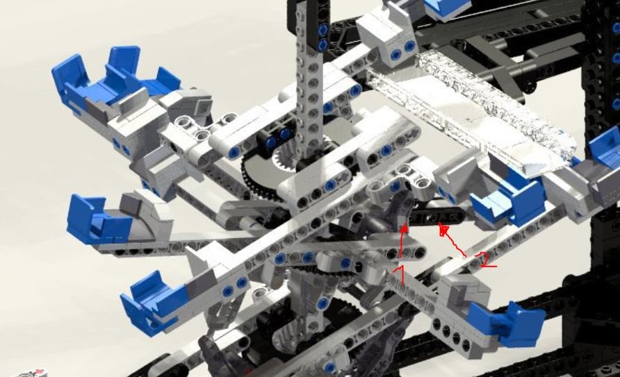

Frequenzberater Posted June 27, 2018 Posted June 27, 2018 BTW, yesterday evening I applied a flywheel to the driveshaft of the module. It was late, so I couldnt test it extensively, but rotation seems to be a bit smoother now. What I also noticed is, that the sometimes jerky movement of the rotor is caused by slight collisions in the rotor structure itself. For example the DBG hinge (1) slightly touches the black connector plate (2) in one specific position of the rotor. This always results in a sligthly stuttering movement. Is it normal or did I something wrong? Also the scoops of rotor 2 and 3 are touching in a specific position. Quote
RohanBeckett Posted June 27, 2018 Posted June 27, 2018 hmm.. I remember something like that happening with mine.. but then fixing it.. not sure if I swapped a part, or had just built it incorrectly unfortunately, I can't help out, as mine is currently on loan, in another state...500+ km's away! :D and I won't be seeing it again until August! (unless @Captainowie wants to unbox it and test it out! ;) Quote
