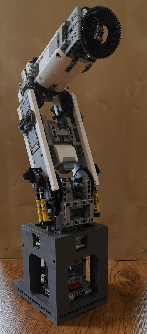

Edit: On with the build and a few more changes. The turntable at Joint 4 with the black 5x7 frame was only connected at the top. There was no real way to add pins to the bottom of the frame because the supports for the gears were in the way. I have changed it to support the axles and gears with a red H beam and double pin/axle to connect the 5x7 frame to the turntable. This eliminates friction between the frame and turntable due to the cantilever effect.
87382541_899752473798099_287778130268835
87519332_554314192107538_706774659544540
89319441_2904985096206896_86177933304298
3%20Axis%20Wrist%20Akiyuki%20Modified%20
@Ankoku
This is my modified 4-axis version of Akiyuki's track robot. There is still a little work to get the ball bucket right but nearly there. If I get a second Ev3 or Lego releases extension cables I can mount the new 3 axis wrist to the tracked robot arm
89260579_621726415039590_793316480602918
Edited by HRU_Bricks
