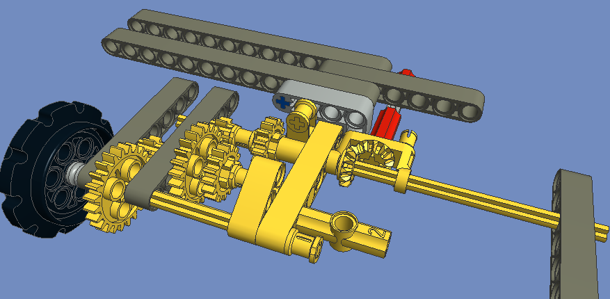

I've had this model since Easter last year and this seems as good a place as any to say what I did to it. Most of the modifications to it here seem to be (impressive) changes to let it lift elephants, but the two things I wasn't happy with were that it can't be steered and it rotates freely about the tracks when that lever on the gearbox is disengaged. I addressed the first problem moderately successfully:
lego gears
Yellow parts are those that are newly added. The 8 tooth gear on the middle axle is sliding; this means - although everything is a tremendously tight fit - the middle axle can be slid back and forth to engage either the 8 or the 16 tooth gear on the long axle. (The bush on the long axle wants to have its indents towards the 8-tooth gear because that gives a little more leeway to slip past it). The angled 3-stud beam can then be dropped down on one side or other of the gears+bush on the middle axle to stop the whole affair slipping, which works better than I expected. All this folderol means one can select a different gear ratio on the left and right sides of the crane, and so it can be steered. Conveniently, it also provides an extra-low gear ratio for climbing slopes.
LDR file for the design.
I've not really got anywhere with the free rotation. I've experimented with driving it through a worm gear, which can't be driven in reverse (and perhaps a clutch so bumping against the model doesn't try and rip it apart) but if the worm gear isn't firmly braced fore and aft it slips, and there's so little space in this part of the model that's quite hard to do. To try anything new here demands disassembling half the model, too.
