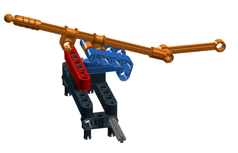

In the video, the steering selector moves in and out when steered. It also has to be lifted and then moved left right or center to choose steering mode. And, in front wheel steer mode, the selector sits slightly higher than in the other two modes.
This is what I came up with that would have similar selector properties as well as fairly simple. And I know the proportions are completely incorrect.
The black pieces are the steering assembly. The orange pieces represent the mode selector which is also connected to the steering system so that is moves forward and back when steered. The selector is shown in the front wheel only position. It would be moved either left or right to select the other modes. The selector would latch onto the red beam. The blue bits would lock the wheels in front wheel only mode.
